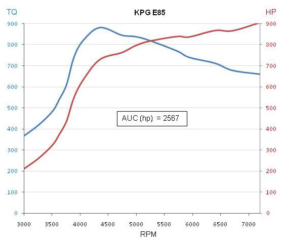

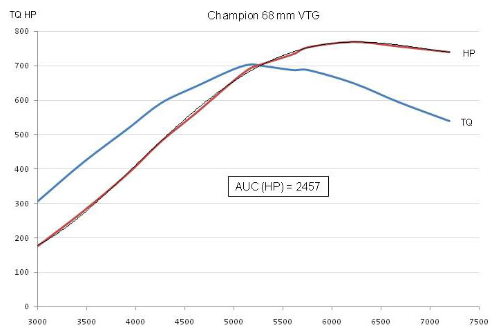

HP AUC from Dynos
Here are some HP AUCs calculated (3000-7200 rpm) for some big HP *****'s. Dynos were simulated from data taken from dynos published on this forum. Actual dynos used for the simulation are attached. As always, the results are open for interpretation....
ID:	302152   Click image for larger version
