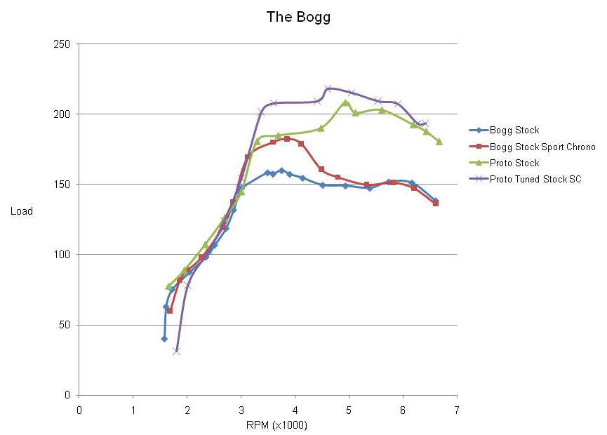

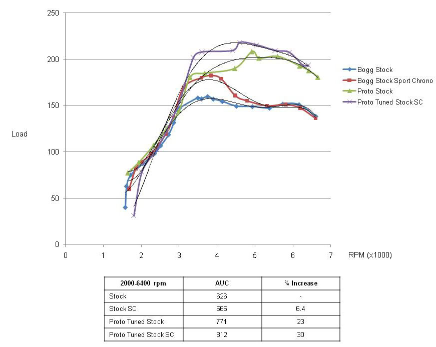

The Bogg (Asher) had some really great data he is able to contribute to this thread. Stock 997tt, stock with SC, Proto-tuned stock (SC off), and Proto-tuned stock with SC activated. This is really great data. He must be a bit **** (ytical)--LOL. Reps to you Asher! Thanks for sharing.
Without line fit (you can see the raw curves more clearly).

Thanks for graphing that Dave. I was looking for this kind of comparison when I was thinking of buying the tune and I couldn't find it so hopefully it will help out someone else who may be wondering what exactly you get for the money. My pbox numbers correlate well with the AUC numbers (I'll post the pbox numbers soon) in the different modes.
