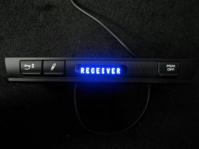

On the note above - does any one have any additional info on this settup (below)? Almost like a little heads up display without the heads up display :P
Cool kit if I could find what it is and where to get it, if it wasn't a total custom job.

+1 on wanting to know more about that dash molding...

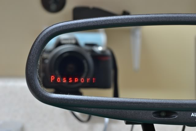

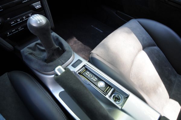

If you google Radar Mirror these is a guy Scott there that does amazing work. I had my control unit hidden in the ashtray and Scott's company (through my local dealer) installed the radar's read out screen placed behind the mirror in such a way that it is not visible when off and easliy read when on. If you have a Vert, like I do, in direct sun it is a little hard to see but you can hear it fine.

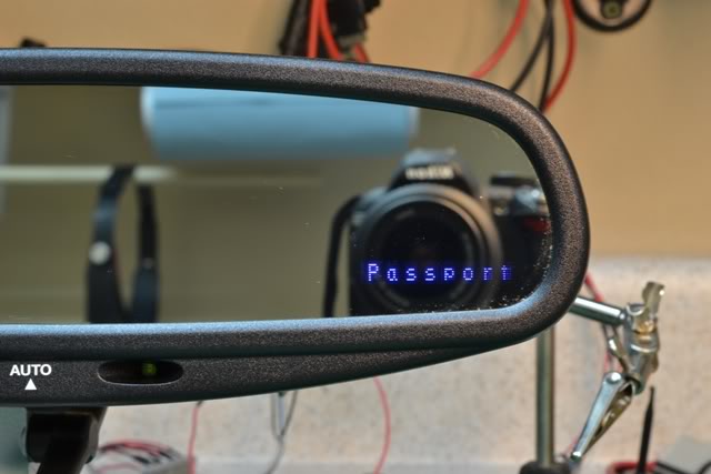

Finding a factory quality solution for mounting the 9500ci display is a challenge in almost every vehicle. We've seen some very creative and professional options but many are comparable in price to our mirrors and the placement for the display isn't always ideal. If you're out enjoying your car you want to keep your eyes focused on the road and the less distance your eyes have to travel to monitor radar and laser alerts the better (and safer).
For future reference we are an Escort and Beltronics dealer and if a 6speedonline member purchases the 9500ci or STiR Plus systems from us directly we will integrate the display module into your mirror for $99.

My car is in the shop right now but I'll take pictures when I get it back. My install has the control unit in the ash tray and the display unit on a custom piece that flows right into the top of the rearview mirror. Looks pretty OEM and hard to detect if the display lights are turned off.
My shop also cut a small section right out of the rear license plate and flush-mounted the diffuser so it doesn't actually stick out. If you're putting it up front then it doesn't really matter anyway.
The nice thing about the way they mirror-installed it is it reverts back to stock easily so you can transfer it to another vehicle (if you're so inclined when you sell your car).
