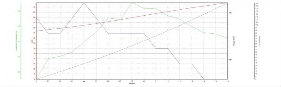

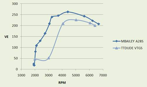

The fastest spooling turbo I know of (even has good top end) is the Tial Alpha 28. With all the supporting mods in third gear, they start max spool at 3100 or so with a really amazing 0.955g at 59 mph (3700 or so). See first graph. There the g (green) line has essentially a 1:1 relationship with torque. I dont know any turbo that can spin early enough to give max torque below 3000 though. The A28 will outspool modded VTGs usually. See second graph...
Switzer uses these turbos in his P800 kit.
