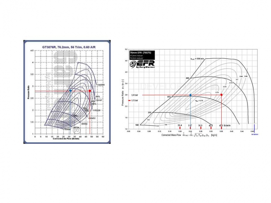

Here's a compressor map of BW EFR6255 turbo...BW's state-of the-art tuner item. Most likely based on the same compressor wheel technology than those 63.5/65/68mm billet wheels tuners are using in their turbos for 997t.
49.6mm inducer / 61.4mm exducer = 65 trim
Here's the next bigger compressor from their line up ( EFR6758 ) :
53.9mm inducer/67mm exducer = 65 trim
In/ex ratios and the flow numbers makes me think this and that. Quote from tuner X's pages: " The factory VTG turbo has a 60mm exducer and 43.8mm inducer ( = 53 trim ) on the compressor side. Compressor wheel on the X turbos has been increased to 65mm (exducer) and 46.9mm (inducer) ( = 52 trim )"
IIRC GT2/997t.2 has 45mm in / 60mm ex = 56 trim compressor wheel.
More info about EFR's: http://www.turbodriven.com/en/perfor...urbos/efr.aspx

OT too but I was considering some EFR turbos for my set-up. Protomotive got some "mocked-up" EFR7076s and those things were huge. Too much fab work needed so it was out of reach for me and just went with bolt-on A3076s. Someone should try these out on our cars.

Todd's been peeking to the dark side... ...42lb/min of flow @ 1.5bar / 75% effiency...390hp each. And not even close to their max. (53 lb/min @ 1.5 bar )
I mentioned these to him when they first came out and sent him the maps. For high boost applications, these would be ideal. Didn't have the coin to do the project. Maybe next project if I ever finish the one I'm working on.
