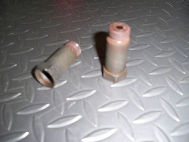

Like others have said probably something loose or maybe need a set of these bung extensions for the 02 sensors ,one of my aftermarket exhausts came with them & i know some exhausts require them.
