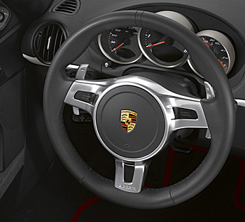

So I stopped by Macarbon this week and looked at a few wheels ready to head to happy customers. All I can say is I'm impressed with the quality craftsmanship and attention to detail. I've attached the wheel I plan on replicating, except the stiching will be in white and the 12 oclock ring will be in white in 10mm instead of 3mm.
As soon as I figure out my issue it's on order!!!!!! Calling all P-car experts please help
