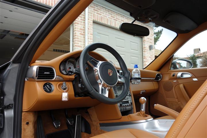

I love my 'new' (bought cheap on ebay) steering wheel

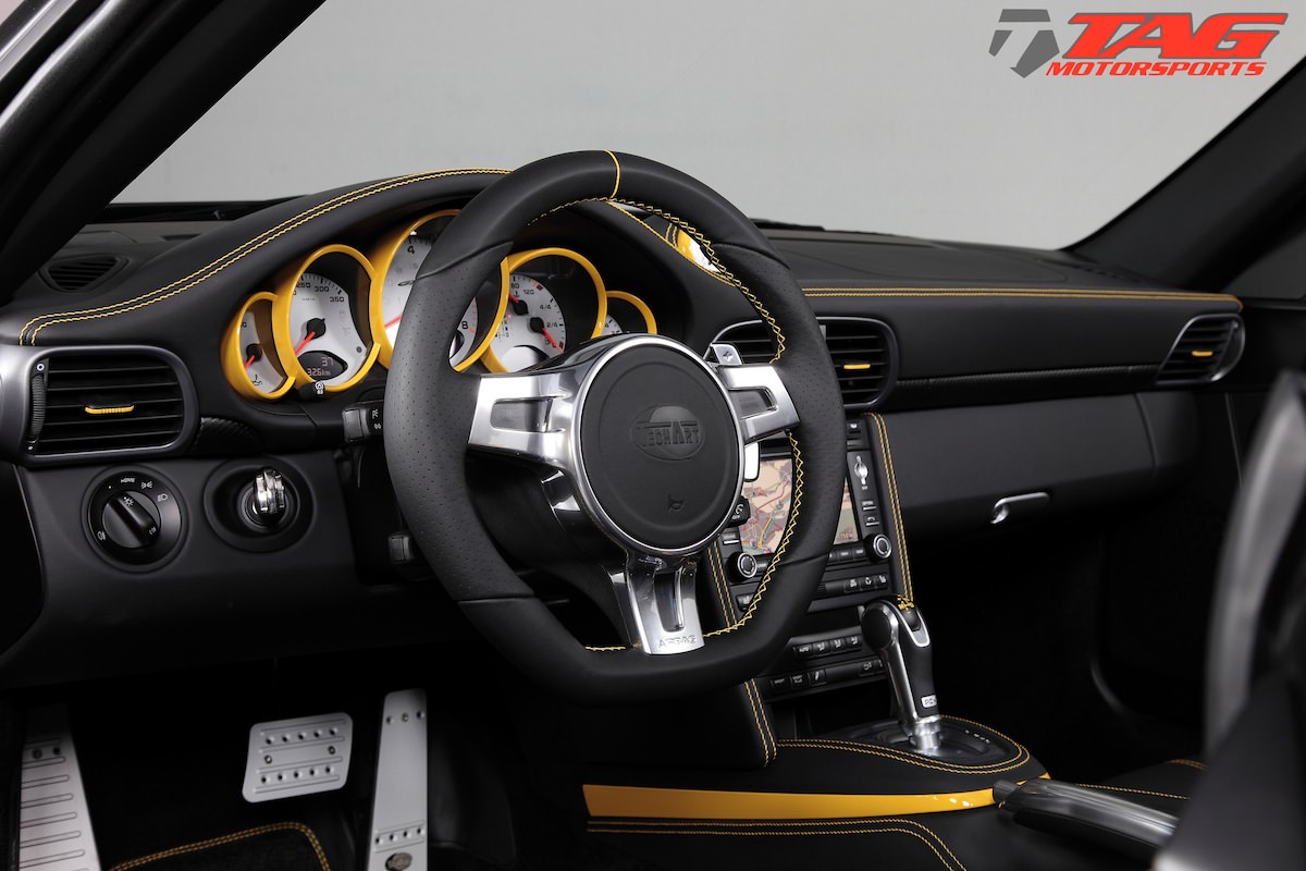

We suggest going with the TechArt Steering wheels. They are cost effective and come with a variety of options/finishes. You could also do a Paddle Retrofit on the PDK Multifunction wheel if you would like...
Most of the standard color TechArt Steering Wheels we try to keep in stock, any type of custom finish/stitch/carbon/etc is about 2 weeks away... Give us a call! 888-920-1766

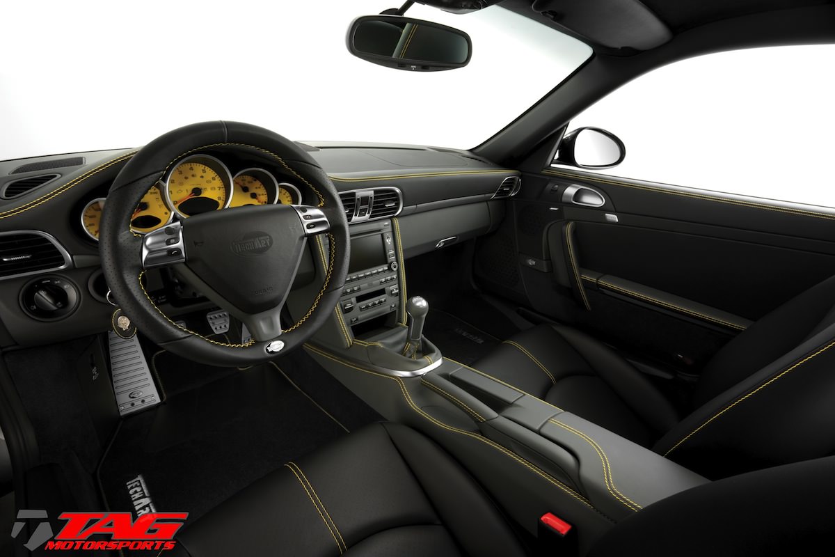

I don't think the 997.1 is that bad. Here it is with my Techart wheel:

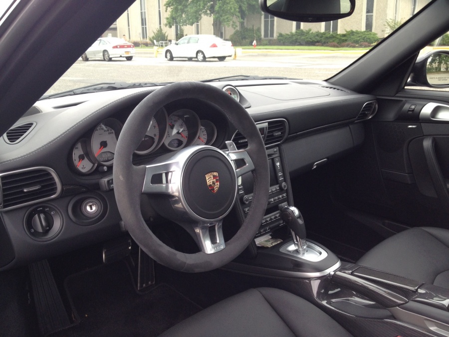

I wasn't a fan of the carbon wheel either. I'm not into the push buttons and the carbon on the wheel makes my hands sweat. I had this wheel put on my car before I took delivery... Paddles and alcantara. It's a factory Porsche wheel. I got mine from Suncoast. They might have 1 in stock normally and if not the order from Germany is a few weeks. I like it alot.
