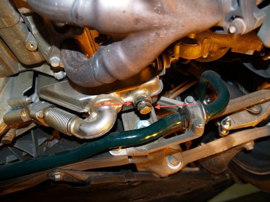

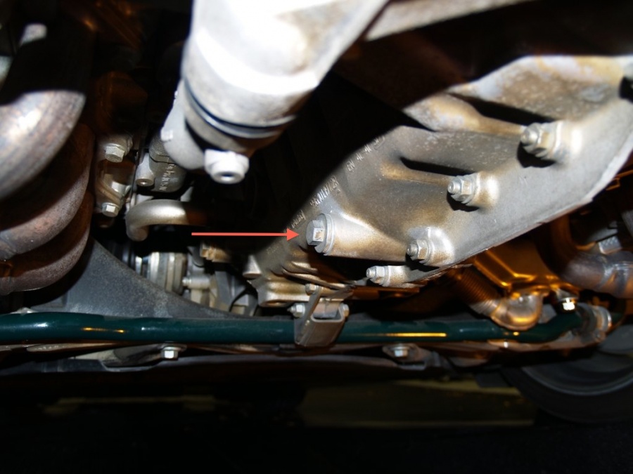

Thanks, but i did remove the two screws shown in the pics below. Is there something that i'm missing?

yes - you still haven't drained the oil tank - you have just drained the crankcase. Your pictures are from Rennlist - look at the first two pictures in that set of 4 and you can see what the drainplug for the oil tank looks like.

Pics are down because of Apple sucks and closed MobileMe.
Here's what you want to drain:

LMAO, well that explains everything- I am a dusche. Thanks, will get it done over the weekend. Im just glad the spark plugs are done, that was a pain in the a$$.
