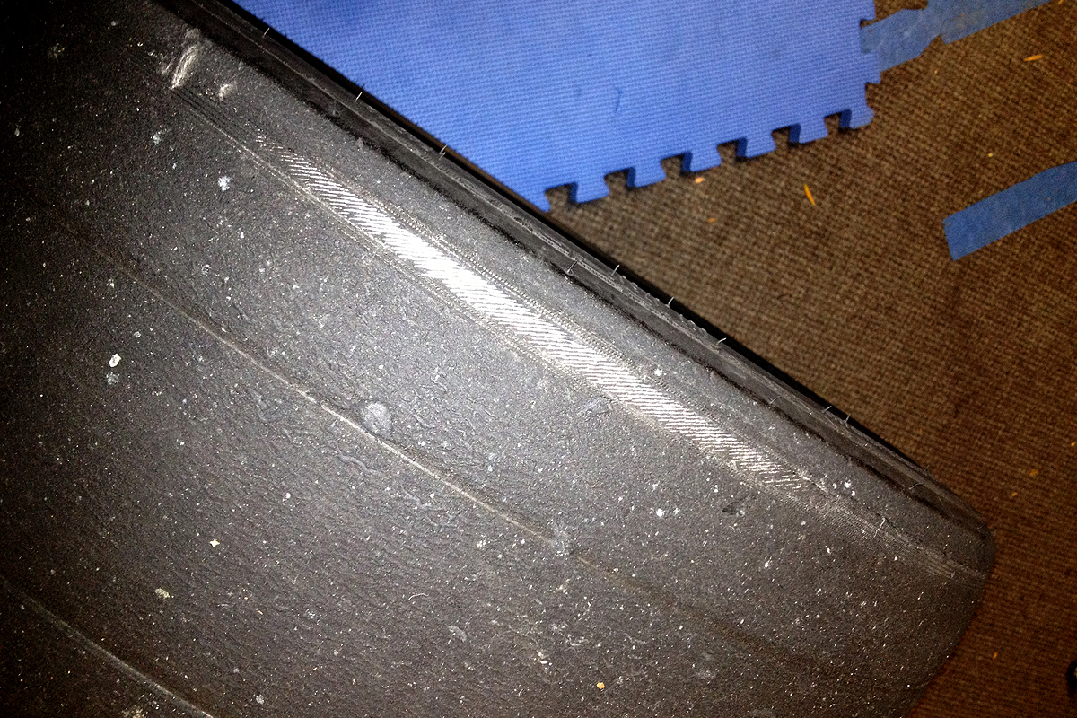

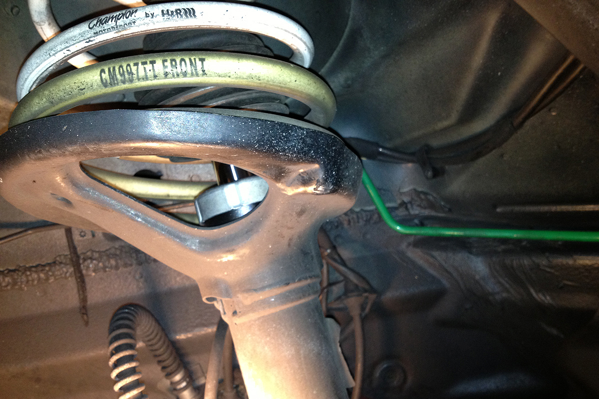

Were both wheels rubbing or only the driver's side?
This just happened recently to me as well, although only on the drivers side.
And the damage it caused:
