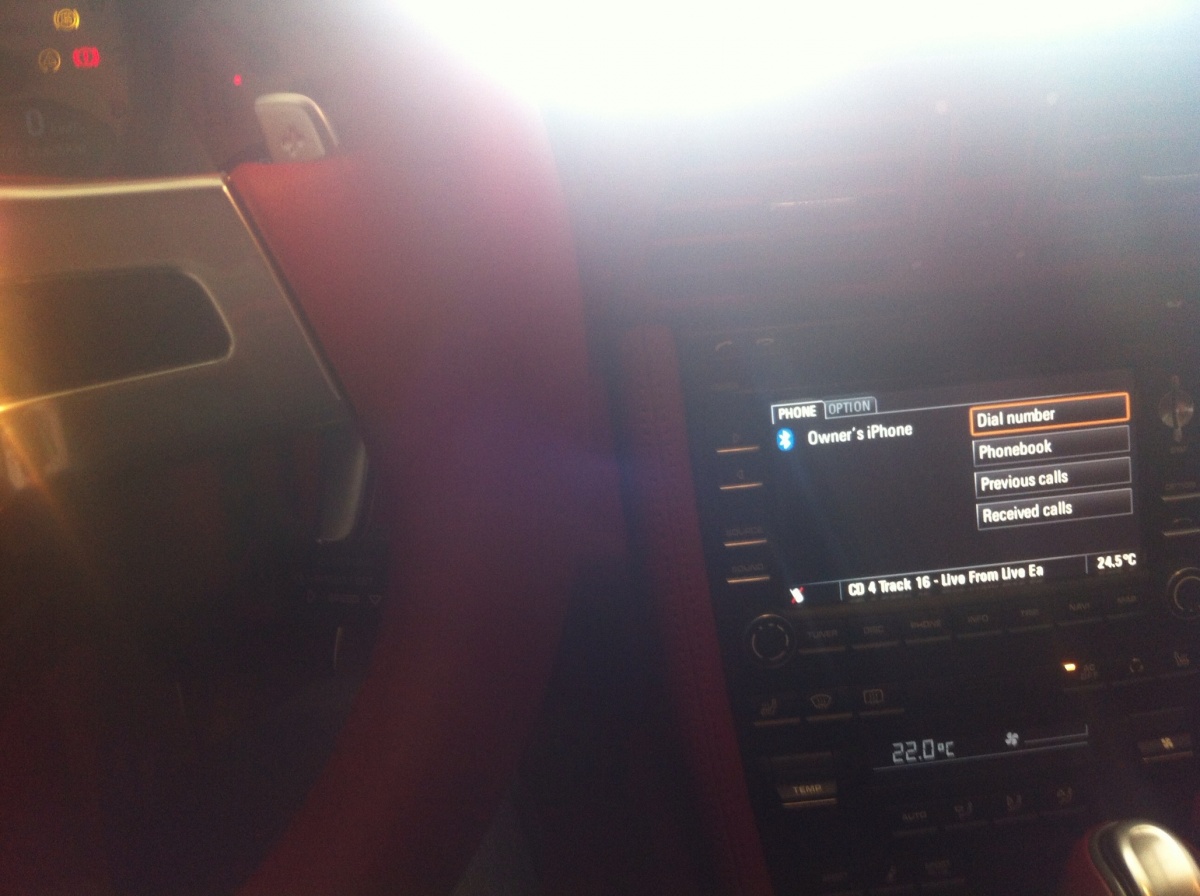

Here is a photo !
2008 model with pdk padles and PCM 3

Originally Posted by PAULG
Sorry!
Nice!! How did you do it? I want it for my 07
