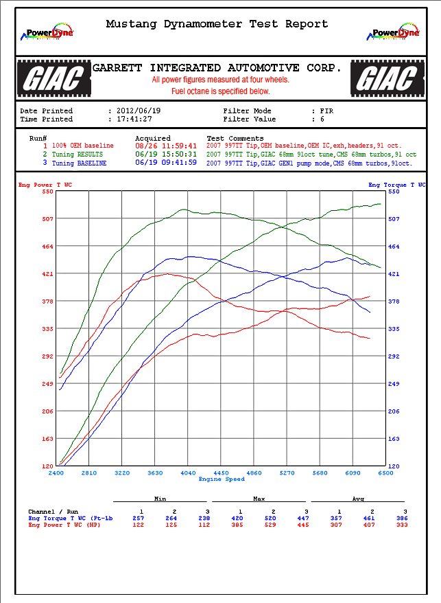

tip or 6speed? Any pbox numbers on pump gas? I'm seriously considering the 68s. Apart from KerCar's numbers there have been very few pbox results posted. Everyone that "promises" to post numbers seems to disappear or sell the car (Slow68, Arone), lol.

Thomas, I think you have seen more kits go through the dyno then most. I like the Champion kit and am seriously considering it. Do you think (dyno results) are higher than most? Do the ratings that Champion claim meet what they are advertising? <O</O
The thing that is important to realize about the power kits is that you will be limited by your supporting hardware. With 68mm turbos and the proper supporting hardware, you will likely run into the limits of the motor and transmission before you run into the limits of the turbo. With the proper supporting hardware, the CMS 68mm turbos do meet their dyno and performance claims.
The nice thing about those turbos is that you can start with just the turbos and build the supporting modifications around them. For example, here is a customer who installed only the turbos (stock inlets) with 997.2 intercoolers. This car is also a tiptronic with a factory transmission (only has our TCU flash). These numbers are very high compared to what we typically see on our dyno (Mustang). For comparison, this car runs mid to high 6's in the 60-130.
