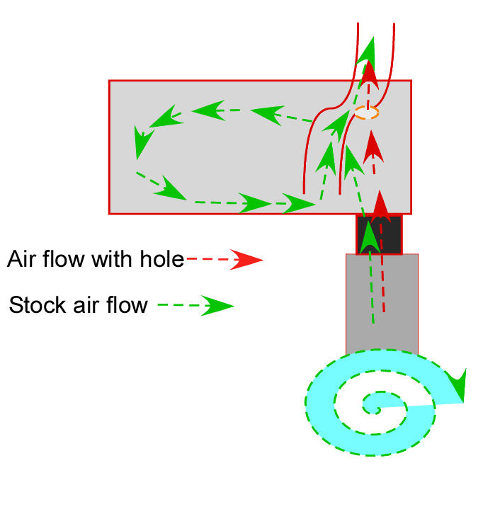

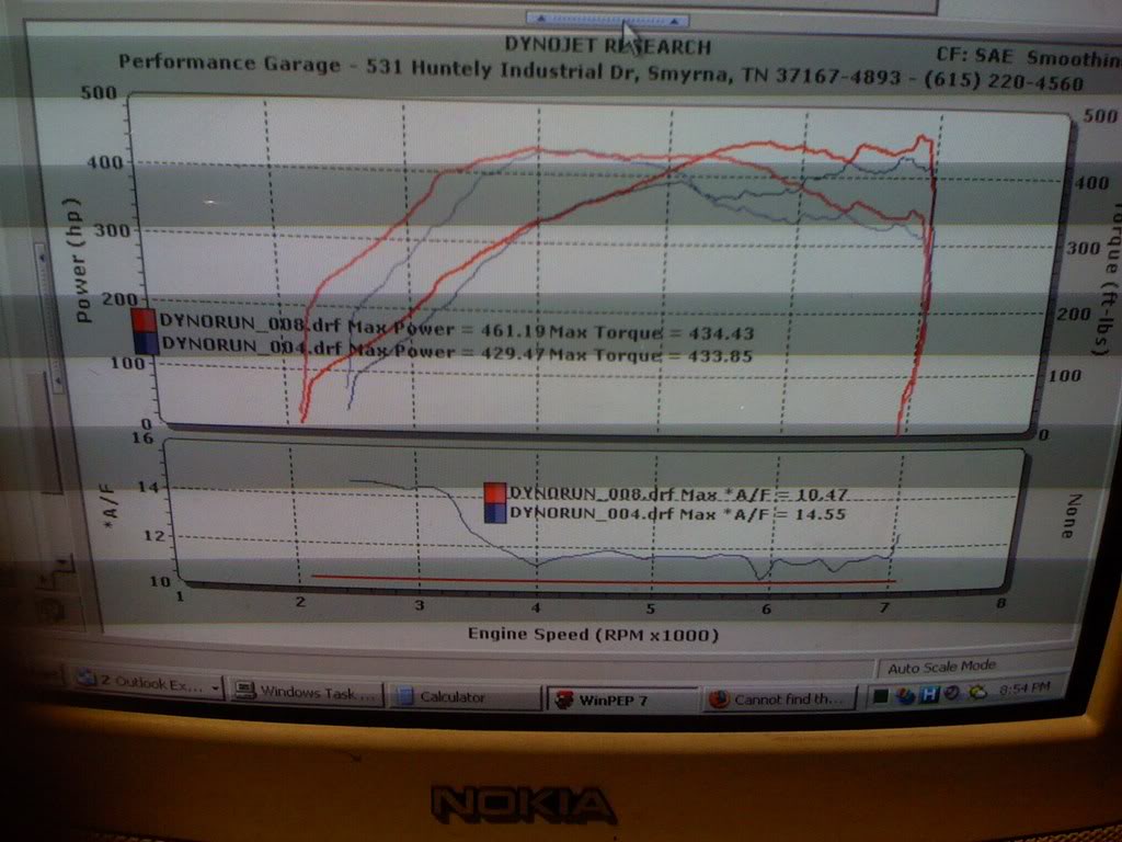

On the 996 Turbo, owners have drilled a 1" to 2" hole through the wall seen inside the exhaust through the two exit pipes. This resulted in a gain of 15 or 20 HP and - more importantly - much improved sound.
Has anyone done this on the 997 Turbo exhaust. Unfortunately, the exhaust's design is different. There is a seam joining two sheets of stainless steel together right where the hole should be drilled.
The question are:
Should the hole be placed under the seam, above the seam, or right at the seam?
Does the seam separate two chambers or is it just this one wall?
Has anyone taken the lid of the exhaust to see how gases are routed?

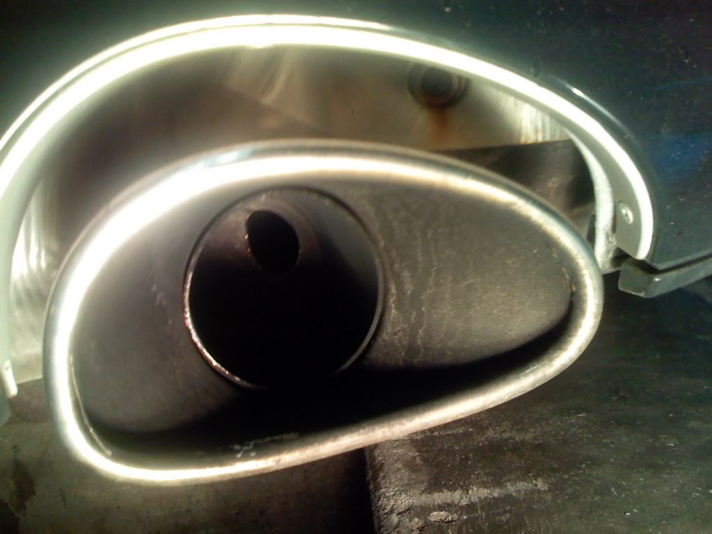

Cool pic. Is that a 997 or 996 exhaust? Isn't that a reverse exit? Looks pretty restrictive.
Agree. I think these OEM gundo hack type mods can achieve a result to a degree but mainly sound wise. Performance gain is a "big" question because there is a lot of restriction still there going by the pic....so I think it is mainly a noise thing going on. Just mho of course.
