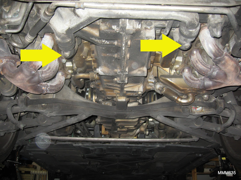

So I have been spending a lot of time trying to track a coolant leak on a 997.1 Turbo. This is a tier 1 Ninja leak, even Porsche had a look and could not find her (I don't know if they pressure checked it as it was done off the books as a incognito favor)
Info.
1.Car has 50k
2.Driven almost every day
3.All services prior to warranty expiration were done at Porsche
4.Already pulled air box /Y pipe and checked glued fittings above water pump (not the source that I can see)
5.Visible leak only occurs after long drive and the vehicle sits for over two hours
Questions:
Has anyone had the fittings just aft of the yellow arrows fail? It seems driver side is deteriorating and allowing coolant to pass. Can someone provide P.E.T. diagram of this area or a part number for those rubber connectors?
I purchased a "universal" coolant pressure tester last week. It is not so universal, as none of the 14 caps fit. I was going to use coolant line off the reservoir rather than cap to pressure the system. I am also now regretting throwing away my old cap. Does anyone have a DIY solution that I can steal or know of a brand of coolant pressure tester that does fit Porsche?
Thanks for any info,
otoppero

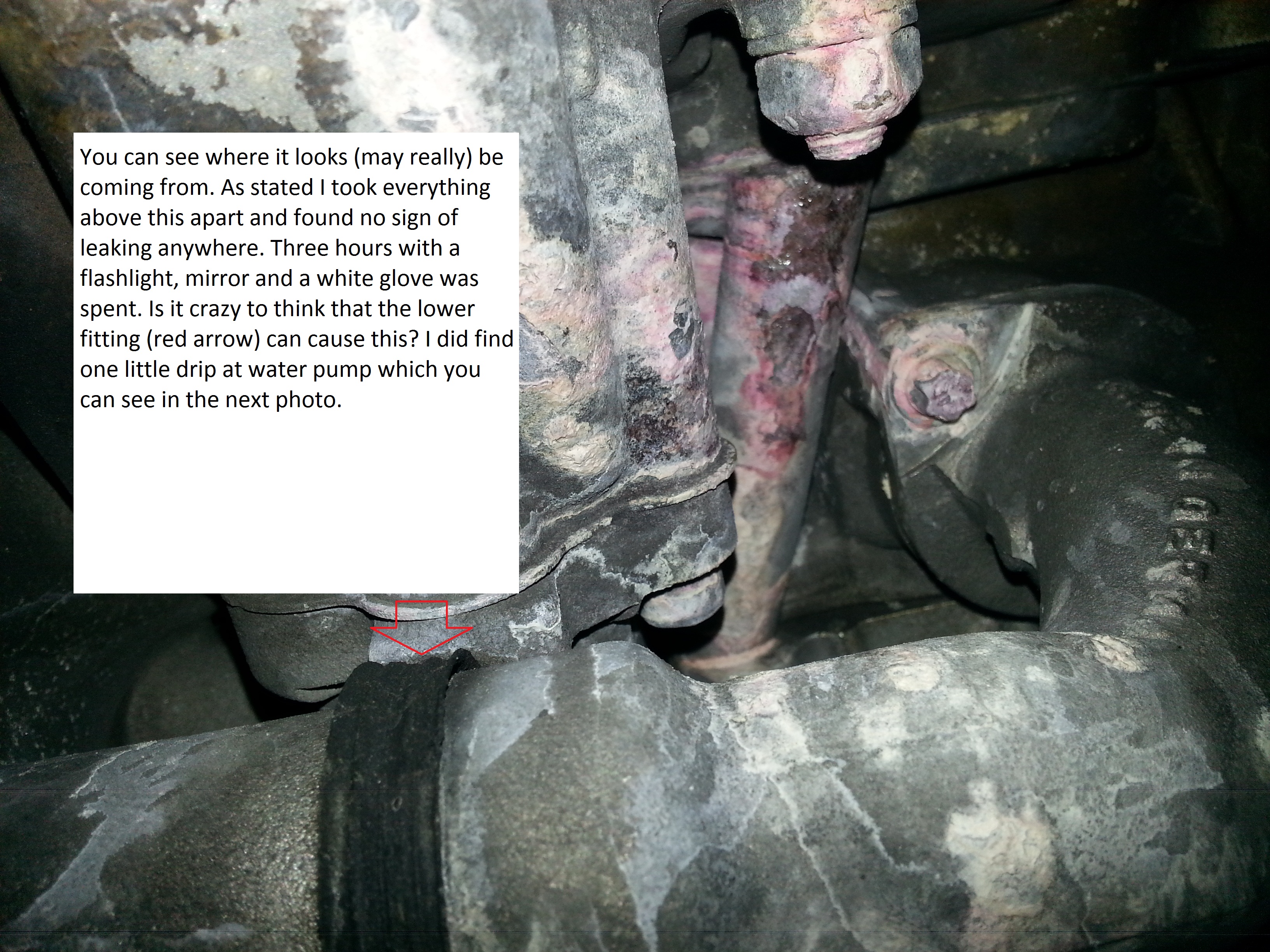

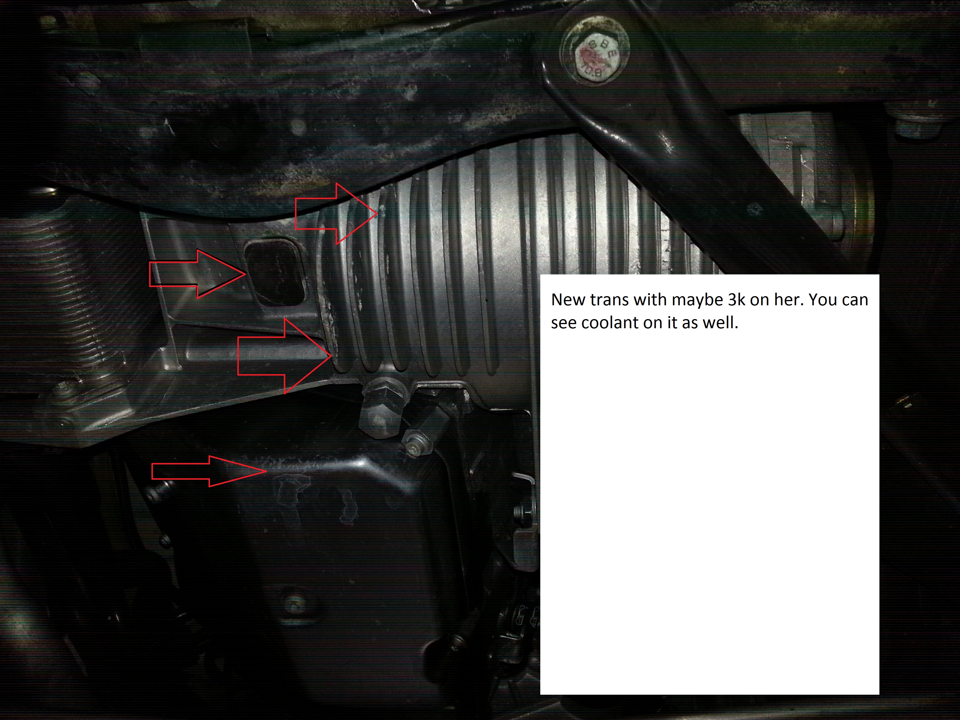

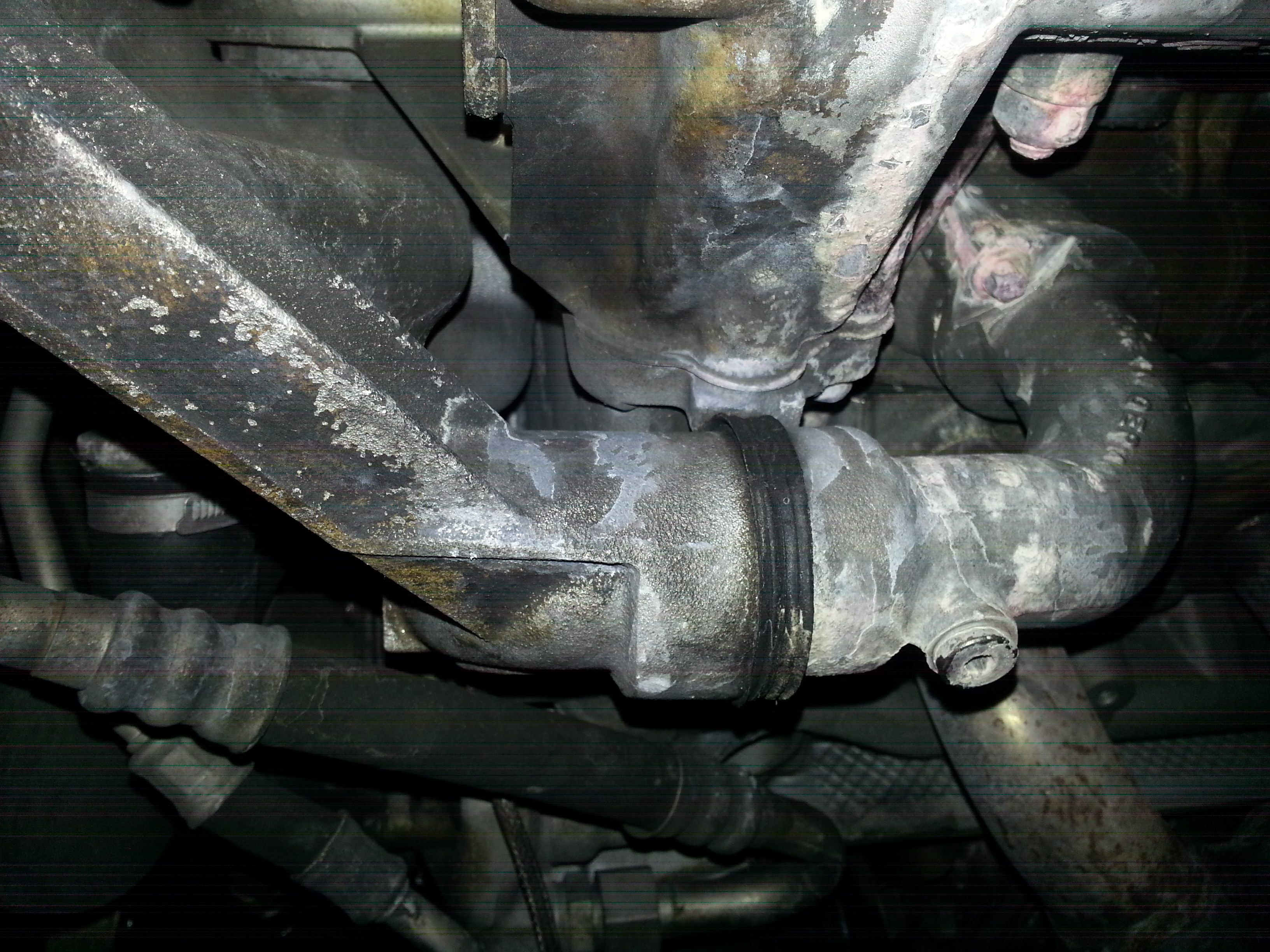

Better picturesClick image for larger version
Old Nov 5, 2013 | 12:52 AM
otoppero's Avatar
Joined: Nov 2011
Posts: 240
From: Bellingham, WA
Rep Power: 37
otoppero has much to be proud ofotoppero has much to be proud ofotoppero has much to be proud ofotoppero has much to be proud ofotoppero has much to be proud ofotoppero has much to be proud ofotoppero has much to be proud ofotoppero has much to be proud ofotoppero has much to be proud ofotoppero has much to be proud of
A few more

Advise taken and was done twice prior. I had cleaned it and let it sit after a long highway drive. No visible coolant till around seven hours later. Small amount, say 1 tablespoon followed by a larger say 1/8 cup a few hours later.
I have let it build up this time to see if anyone had experienced the same symptoms in the same area. I was hoping the residue would help others pinpoint the leak location. It has been to Porsche, with no results. I have had it up on the lift in my shop and have checked the usual suspects with no results either. It never leaks when I'm looking at her .
I also agree with you guys the leaking that must be happening while driving is being moved around with the air under the vehicle. I just can't find the dam# leak.
Any advice on a part, hose, fitting or clamp in that area that I may have not checked would be greatly appreciated. Maybe a PET diagram or picture if possible?

I had a coolant leak 3 months ago and it was the 1 of the 3 plastic hoses that are known to fail below the intake manifold in the middle of the engine.
The first sign of leaks were coolant streaks underneath at the bottom of the engine and even continuing onto the rear exhaust can.
Whilst I had this fixed I also checked all the bonded coolant connections and I could literally pull them out with my fingers so I would check those too once the engine is dropped out.

My car pulls a fast one and now wets the bed with what appears to be transmission fluid very very small amount. I'm not sure why she decided to change fluids last night other than to make me look like a liar. I did a simple test of putting down a large cardboard box flattened on the ground. I have done this before and it usually shows coolant drips from multiple areas but last night it appears to be Trans fluid that leaked out (found a little coolant 1/3 teaspoon too after further inspection). The plot thickens with my disdain and confusion.
Last edited by otoppero; Nov 14, 2013 at 03:37 PM. Reason: further inspection found coolant too
