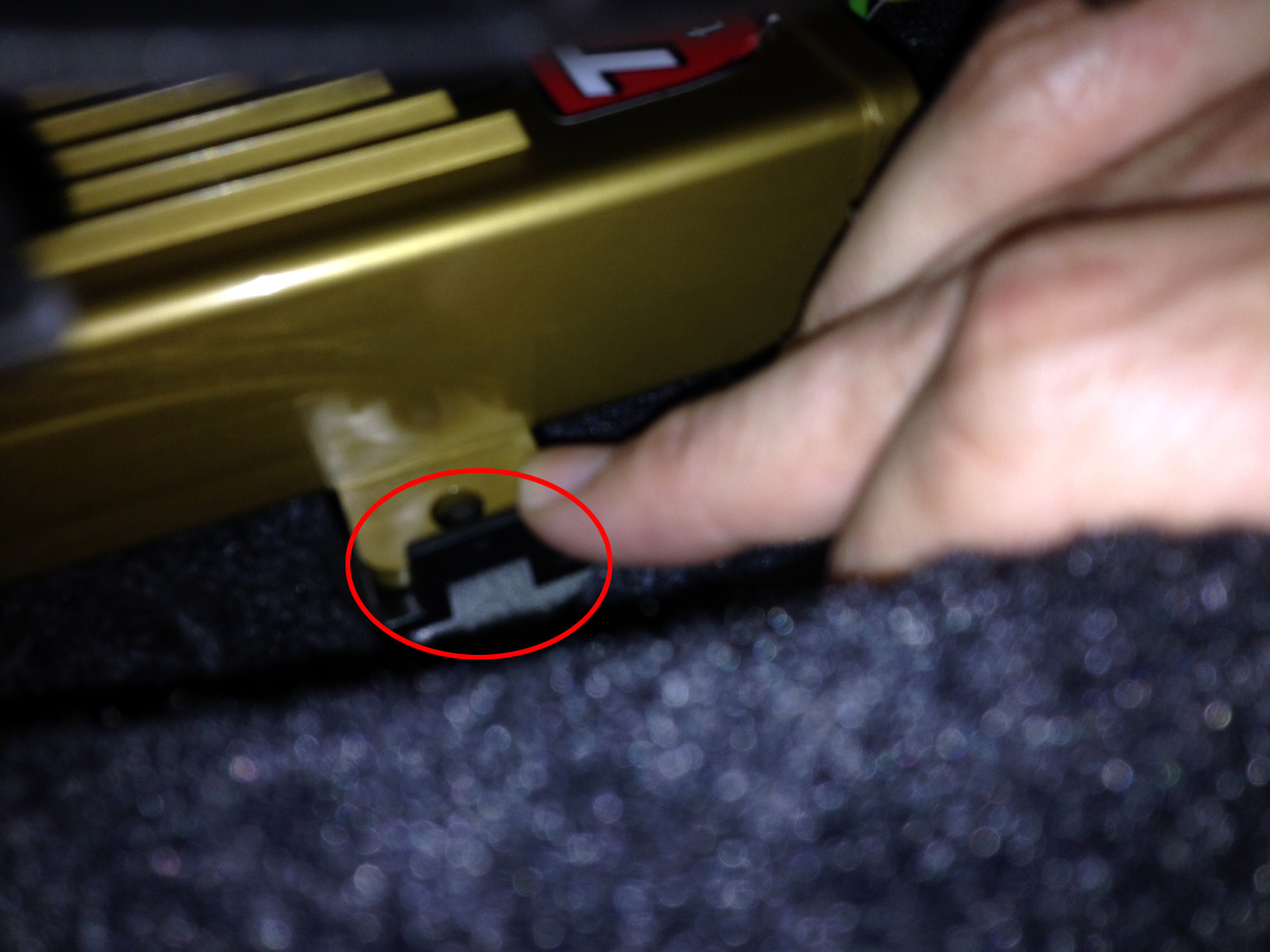

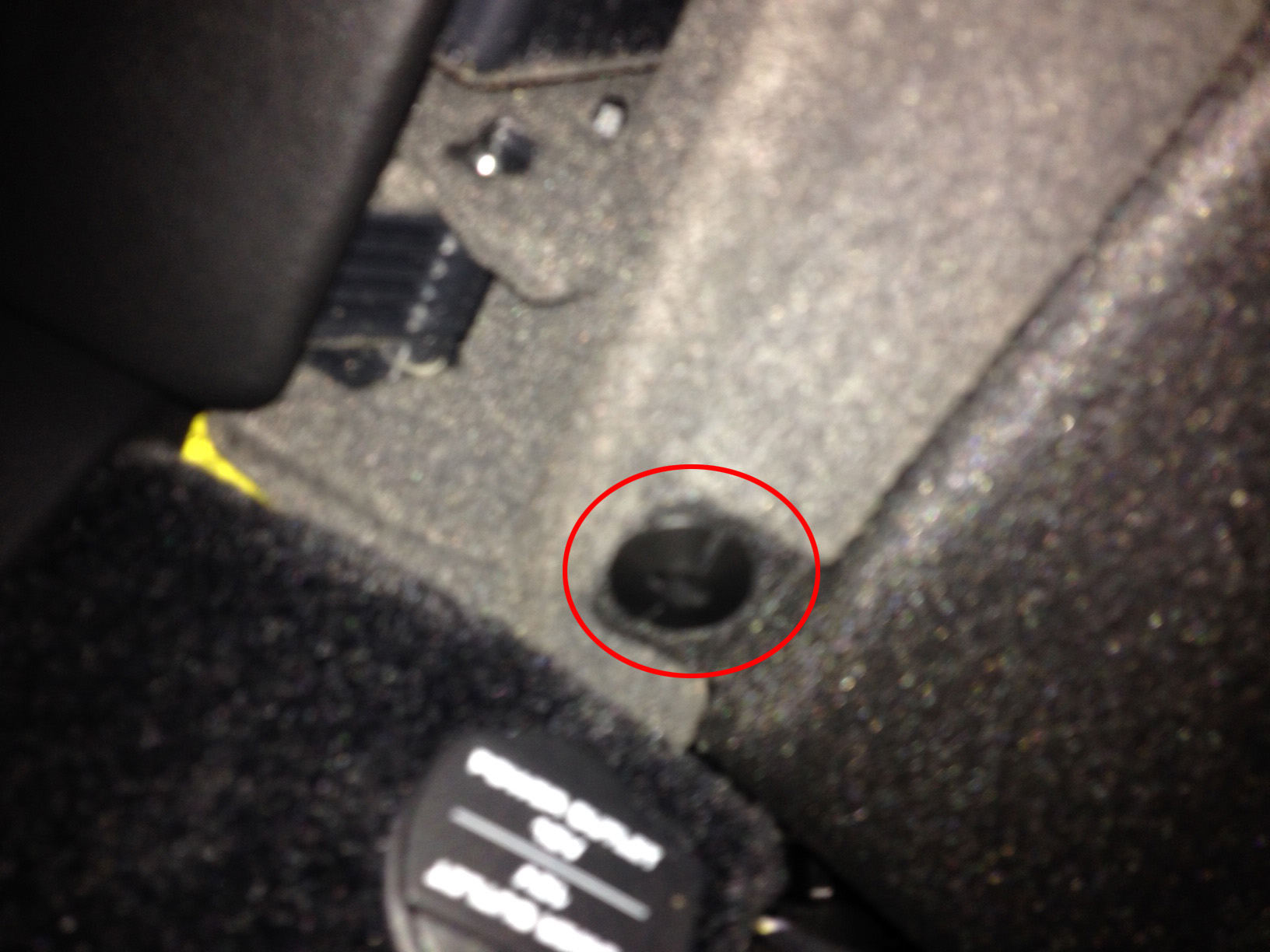

Install is easy once you figure out how to get to it and remove it. First, take off the four plastic screws holding the soft lining underneath the glove box. (sorry for the blurry pic) The control unit is over by the wheel well.
I made the mistake of taking out the mounting bracket along with the control unit. You can just push down on the clip circled in black to release the control module, which then you can slide out.
