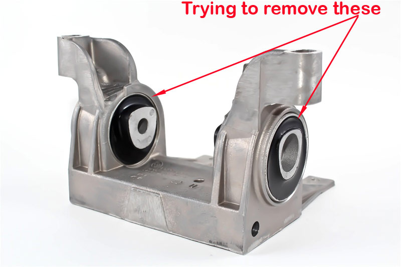

I am trying to install a set of 75A transmission mount inserts. I have the car on a lift and supported the tranny and removed the carrier.
Now I am trying to get the factory/OEM inserts out, and cannot really think of any good way to achieve this? The rubber is super tough. I do not have a press, so am thinking of ways to cut it? hammer it? Heat it?
Just looking for thoughts here and perhaps if anyone else has done this upgrade, how you got the factory inserts out of the carrier.
Thanks!
DC

I'm not sure if there is enough clearance but other times I have dealt with bushings like this, I've drilled holes in the rubber which made it easier to cut. Once you cut the rubber piece out of the middle it shouldn't be so hard to use a chisel or something to bend the metal out. This is always a pain, good luck!

Update - Got them out....Screwdriver wedged between sleeve and bushing ring, opened up enough to use a chisel on the edge of the bushing...squirted some PB Blaster around the ring...couple of taps and it popped out.
Tip for anyone doing the inserts install (or just reinstalling the mount...When you try to align the bushing with the bolt holes in the tranny....it is a B*** to get lined up. I used my laptop and a small endoscope camera...jiggled it around with the camera in the bushing hole...and I could see through the camera when the threads lined up...then bolt went right in! Otherwise would have likely been fiddling for a LOOOOONG time.
