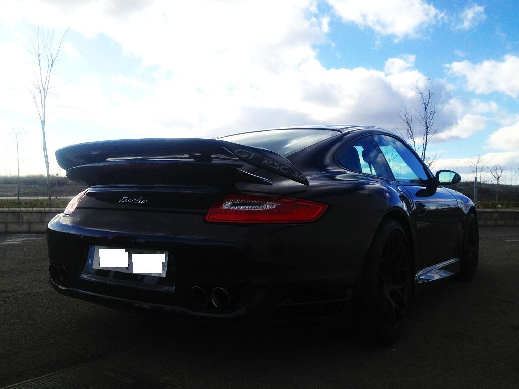

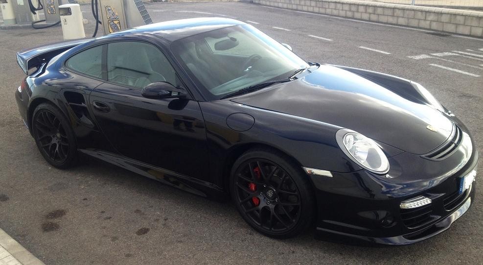

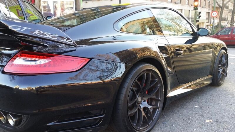

this is my car porsche 997.1 TT
on my list of mods are:
intercoolers GT2 rs
exhaust sistem Cargraphic 200 cells
FVD ecu
first install the exhaust system,
and then tune the ecu FVD
there was a large difference in power before and after ecu tune
my question is.
VTG if I upgrade, I will feel a difference in power to justify the price?
I need someone to tell me their experience,
thank you very much and a hug to all
