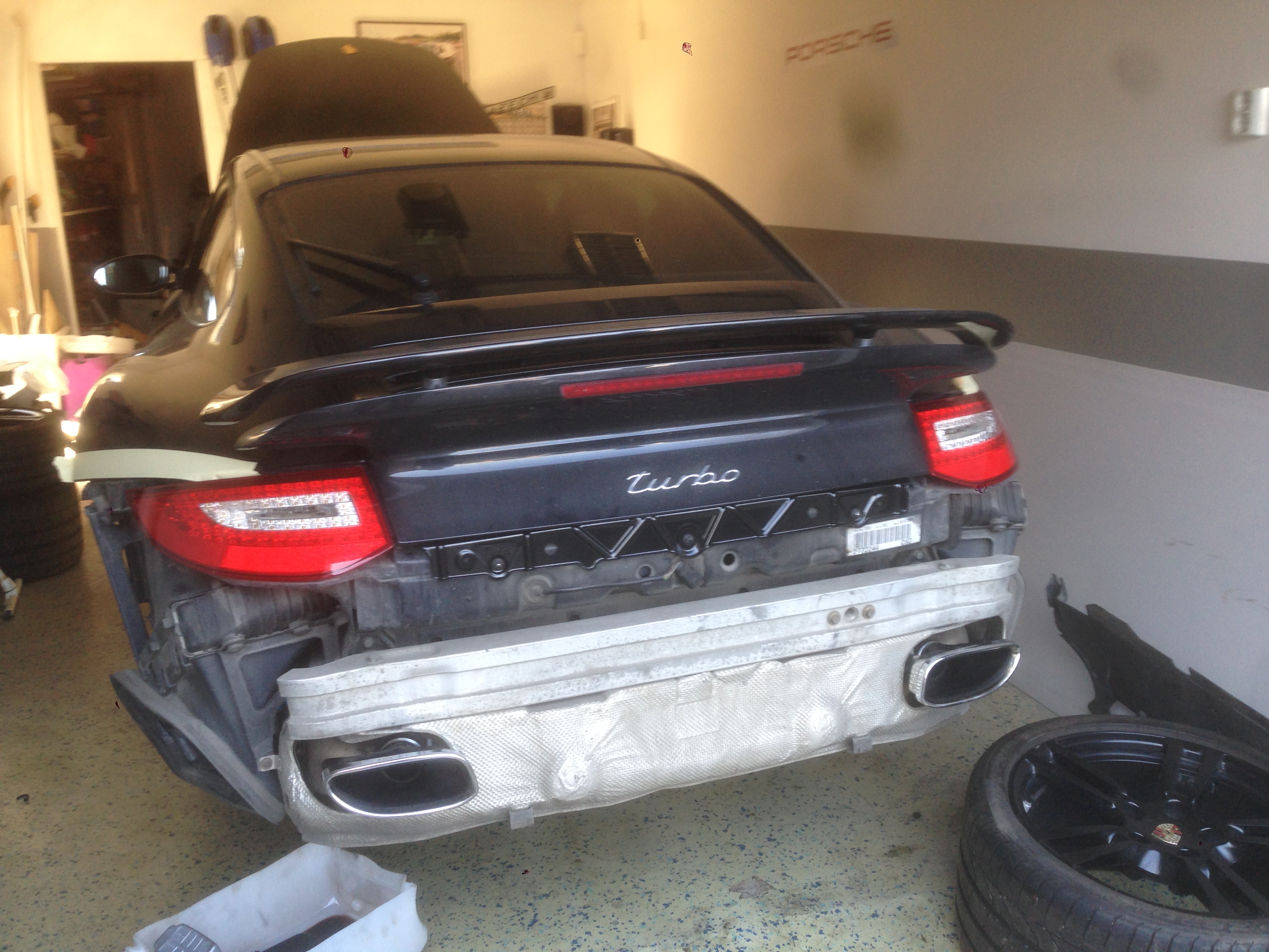

Hello,
I have tried to read up on some information about the conversion regarding the facelift conversion to gen 2 from gen 1, i currently have everything, the lights, the new rearbumper, bumperbracket, the box for the lights, the new tailpipes.
The problem is that the new gen 2 exhaustpipe is centered while the old is not centered, so the pipes will not fit with the new rearbumper, i have read that it has to be modified a bit, but how? Do you guys have any tips how it should be done?
This is what i want:
http://www.design911.co.uk/pages/ima...ery=1&igid=100
The attached file is my car, but the gen2 bumper will not fit where the exhaust pipes are.

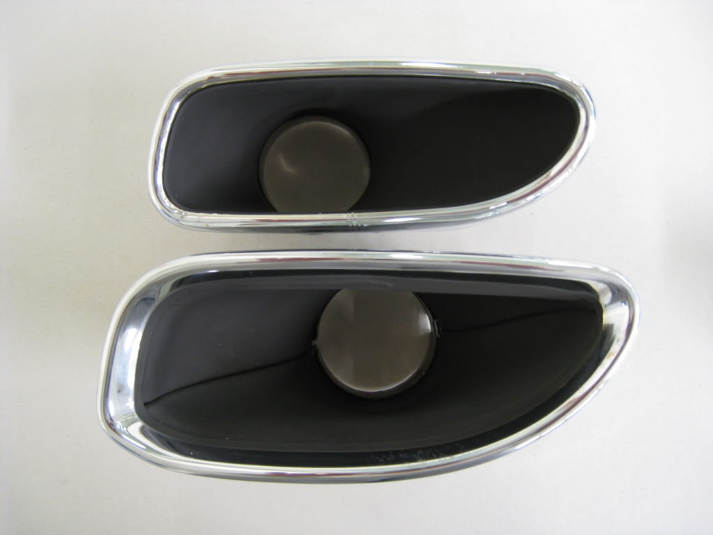

This is the diffrence

Besides not being centered, the .2TT exhaust tips are 65mm while the .1TT are 60mm
Your best option is to buy .1TT aftermarket tips.
Personally i don't like this option, the exhaust surrounds are too big.
2nd option is to modify your exhaust (cut and weld) so it is centered with tips and bumper.

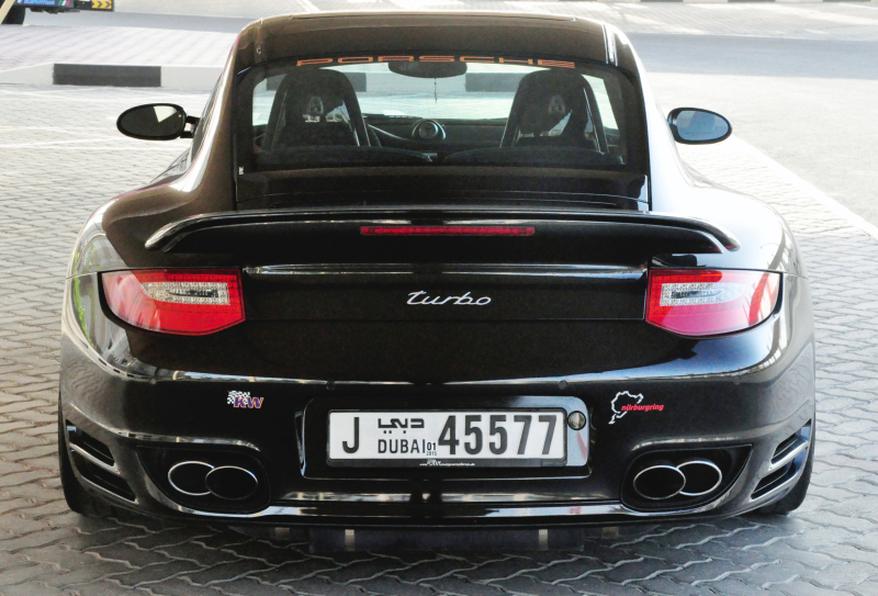

I have the Techart tips (dirty tips in below pic). There are other dual tip exhausts in the market like fabspeed but they are generally round tips.

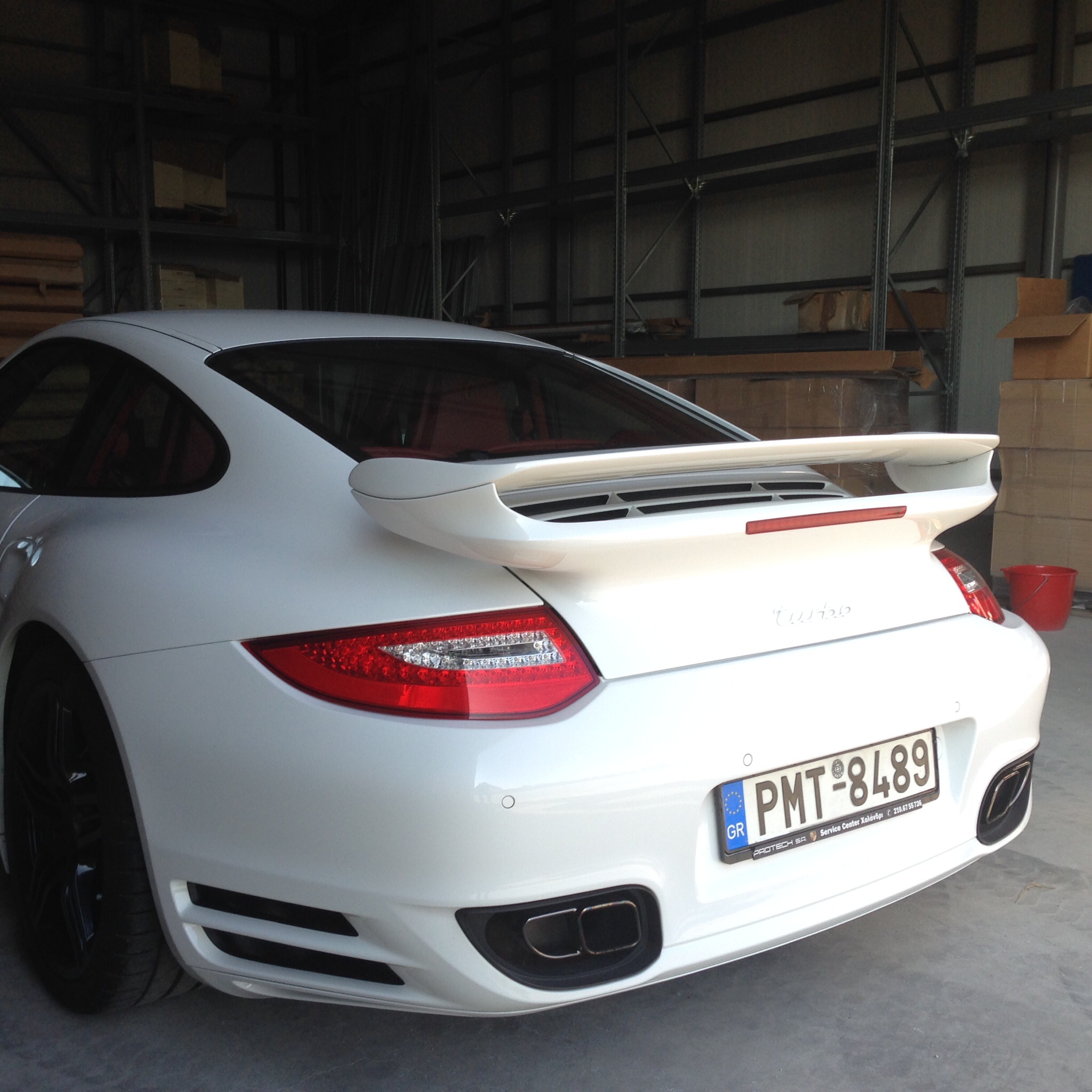

I had europipe 1 and I made the led conversion in my car but they told me not to make the welding and cuting solution because maybe with this to change the pressure of the exhaust and somethink else,is not good for the car,someone who knows here maybe he can clime and tell us for sure.
Finally I put aftermarket tips and you have 2-3 solutions.
