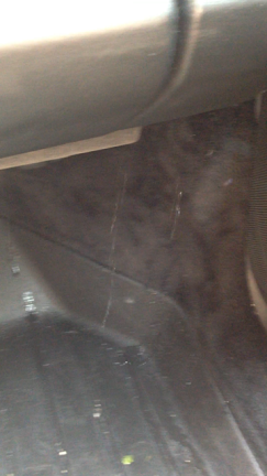

I just picked up a CPO'd 09' Turbo. I drove it in a thunder stormed last night and water started to seep pretty bad on the passenger side near the glove box. It was a lot of water, around 16 ounces. I duplicated the occurrence after washing the car.
Has anyone ever had this problem before? Probably not an occurrence that would be caught during the CPO inspection. I hope it's just a loose seal somewhere.
Sorry for the crap pic.

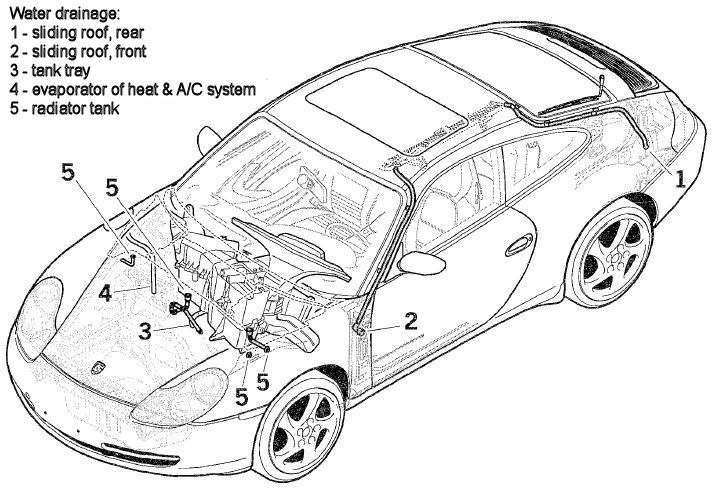

OK so it down poured here in chicago today and I was right in the middle of it. AGAIN water seeped its way into the cabin. Took a closer look under the cowl and saw the drains. They aren't hoses that are visible but actual drains. I stuck my finger in the one that appeared to be backed up and sure enough lots of silt. May have found the culprit here.
Did a quick search on 997 drain clogs and didn't come up with much. Not much is said on how people unclog these besides using compressed air. I'm just worried that the hose may come loose and cause a bigger headache.
I checked out the CPO check list and couldn't find anything on there regarding the checking of the drains before it could be CPO'd so that could be a reason why it was never done. I'm pretty sure the dealer will charge a ridiculous amount to perform this cleaning.
This is my 5th 997 turbo and I never even thought about the drains until this incident.

My only advice is to be careful not to push those hoses/drains down into the "black hole". That will be an expensive repair. I had the dealer clean them for me (not sure how much I paid, but I am sure it was too much - I would say at least one hour of labor) as I wanted their name on their if anything went wrong.
If you do it yourself, move gentle and move slow.
