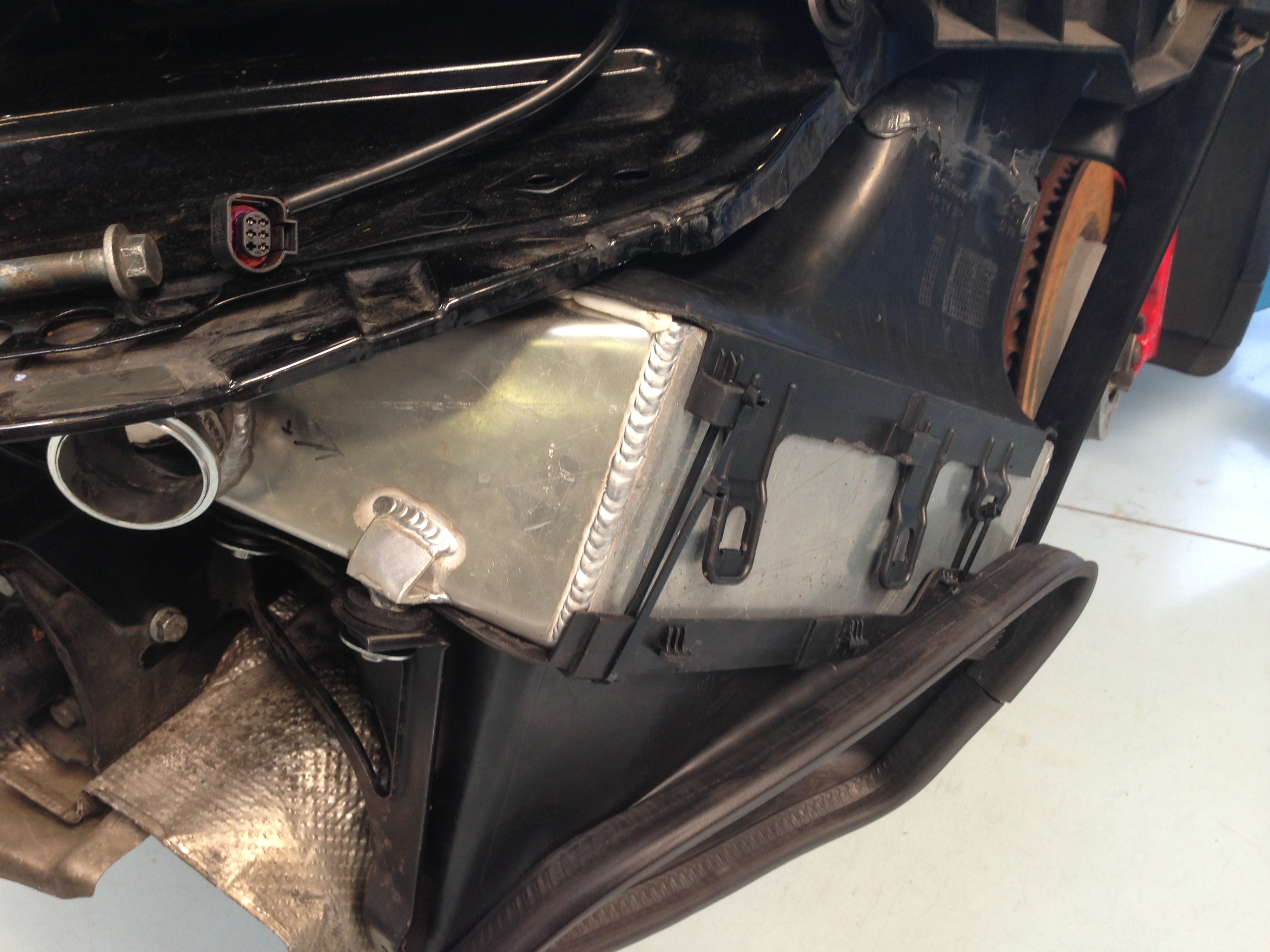

@Bobbyfali
no problem, i will.
60-130 and 100-200 km/h I do not dare yet
Because in 3. gear 2 bar boost is to much for me.
i will tried at first with 1,6 bar
(0.8 and 1.6 bar selectable boost)
max. boost is 2 bar.
i will test it in 3. gear without shift
i think it will be a 3,4-3,8 100-200 km/h or what do you think?
front lip and side skirts are from 9ff.
