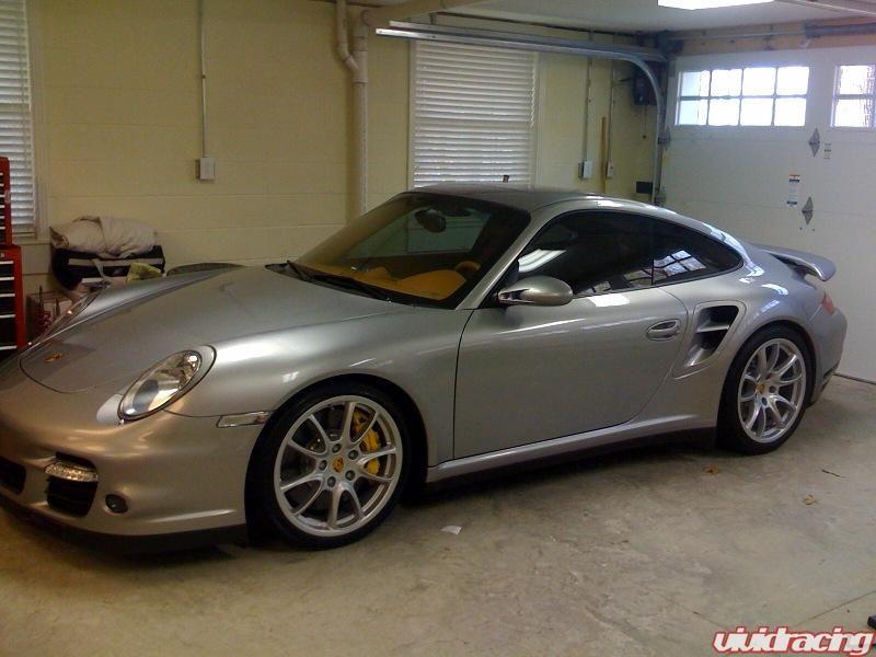

Hey guys,
I have a set of OEM 2008 GT2 Wheels on the way which will go on my 997.1 Turbo. I know from the factory, Porsche uses 5mm spacers for the rear on the GT2.
My question is, has anyone run slightly more aggressive spacers with this set up?
What I am trying to figure out now is... is there a spacer set up that would be even better than the Porsche factory spec? As in, if I use say... 5mm in the front and 7mm in the rear, will I get an even more flush look with no detriments?
Has anyone tried this?
For reference, here is a 997.1 Turbo with OEM GT2 wheels. Same set up as me. Thanks!

Originally Posted by acf
Hey guys, I have a set of OEM 2008 GT2 Wheels on the way which will go on my 997.1 Turbo. I know from the factory, Porsche uses 5mm spacers for the rear on the GT2. My question is, has anyone run slightly more aggressive spacers with this set up? What I am trying to figure out now is... is there a spacer set up that would be even better than the Porsche factory spec? As in, if I use say... 5mm in the front and 7mm in the rear, will I get an even more flush look with no detriments? Has anyone tried this? For reference, here is a 997.1 Turbo with OEM GT2 wheels. Same set up as me. Thanks!
What are the offsets on the wheels? Are you running 245/325 tires?

Looks like OEM gt2 wheels are as follows:
F 8.5x19 offset 53
R 12x19 offset 51
I think I was told to run 305 on the rear rather than 325, to not cause problems with the awd diff in the turbo?

1. Either run 235/305 or 245/325
2. A 305 on 12" rim is not recommended by tire manufacturers, many have done it some say it looks stretched others say its fine. Plenty of debate on this but I tend to agree it looks stretched and again not recommended to go 305 on 12" wheel.
3. Spacers sizing also depends on your visual preference. 7mm with either tire size will be fine.

Go with 305 on the 12" , you'll be very happy ! Perfect look.
Here is my car with 305 on GT2 wheels. No spacers.
For reference here a 305 Bridgestone on a 19x12 BBS. Not stretched at all. In fact looks much much better than 305 on 11" imo.
