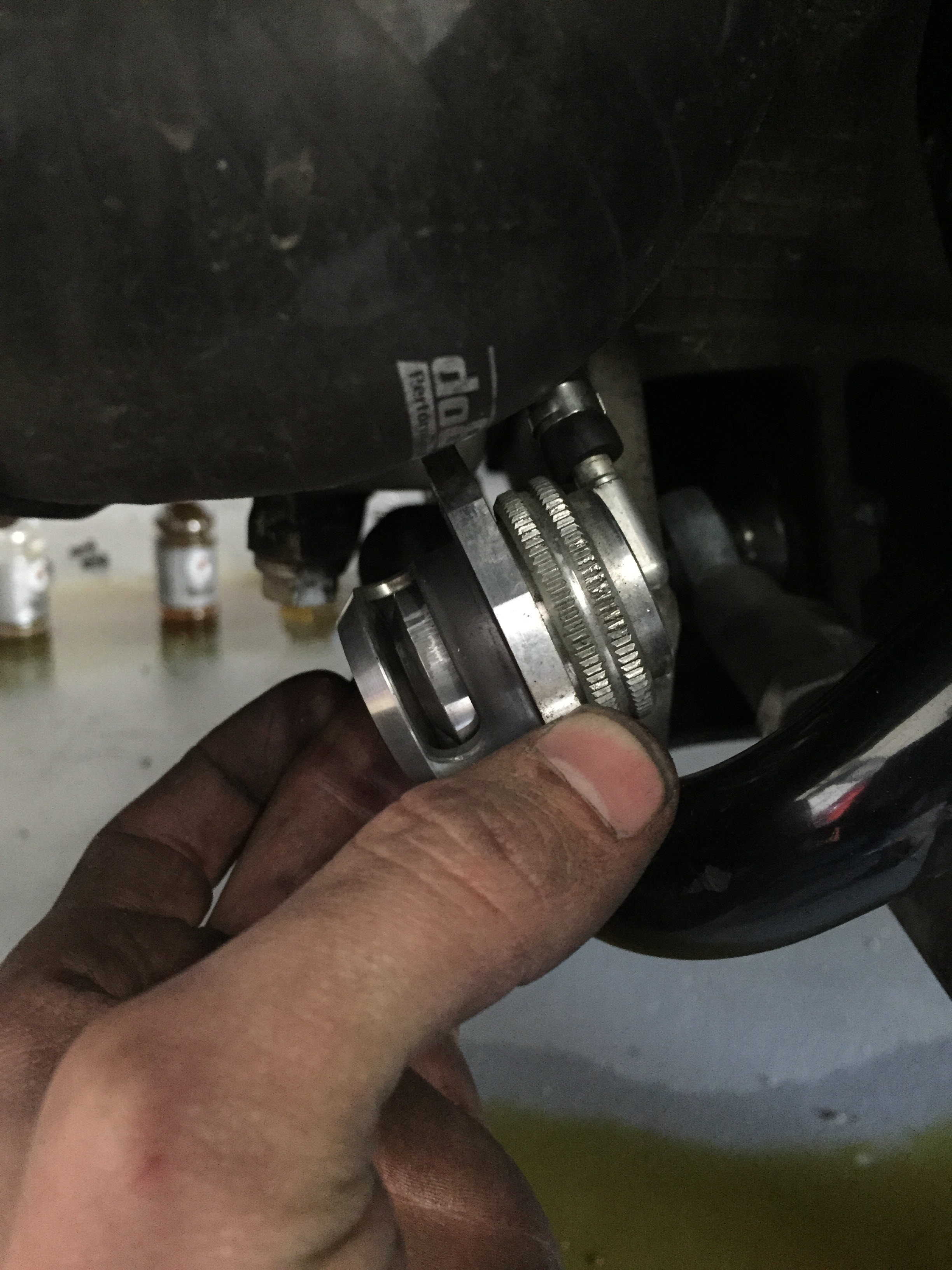

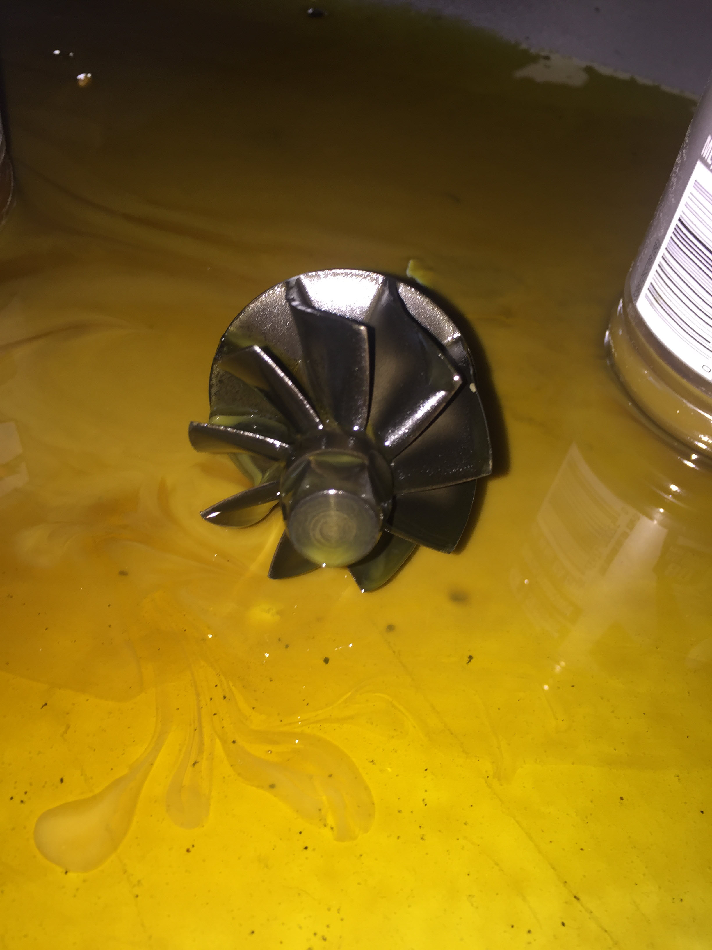

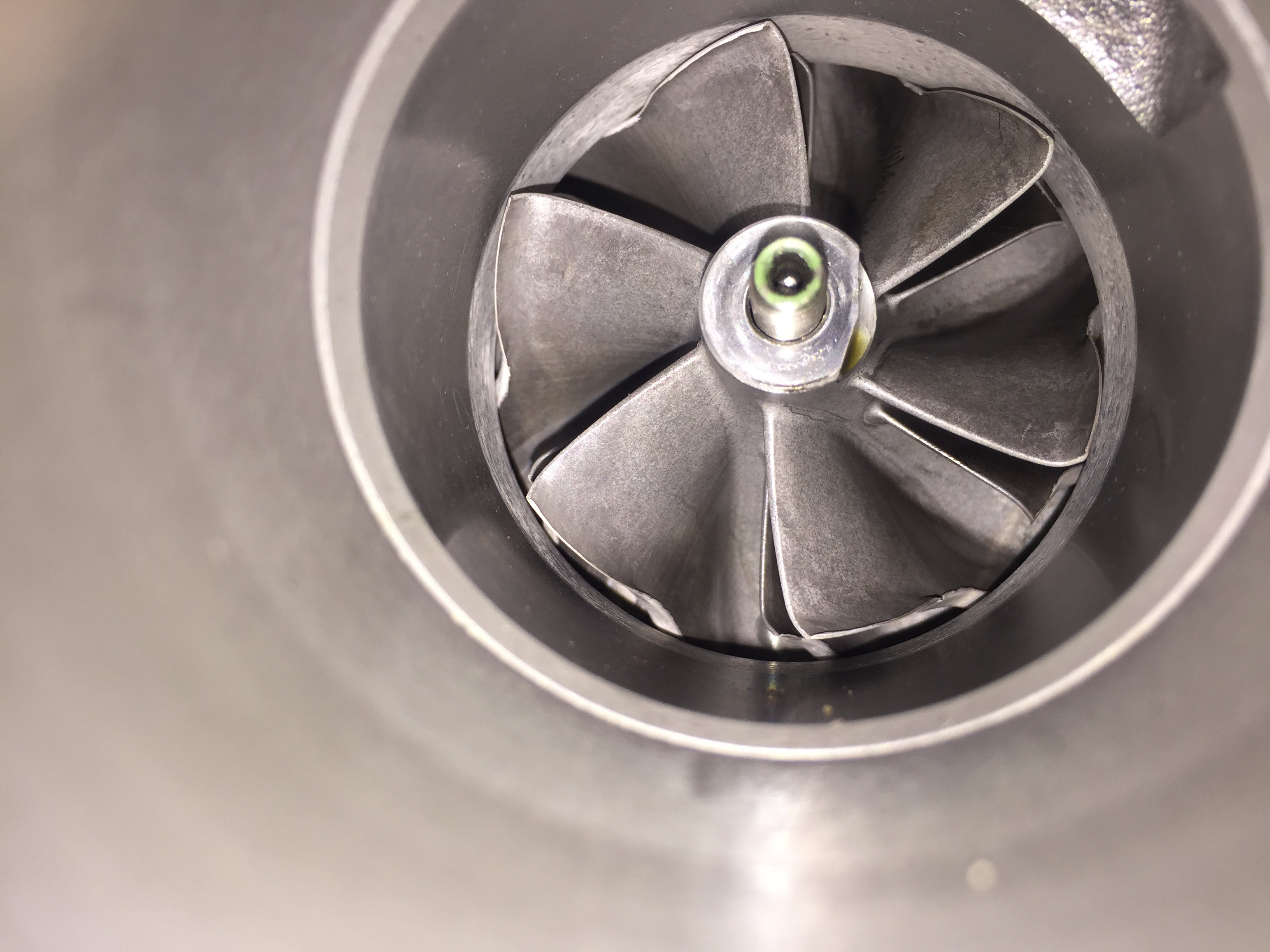

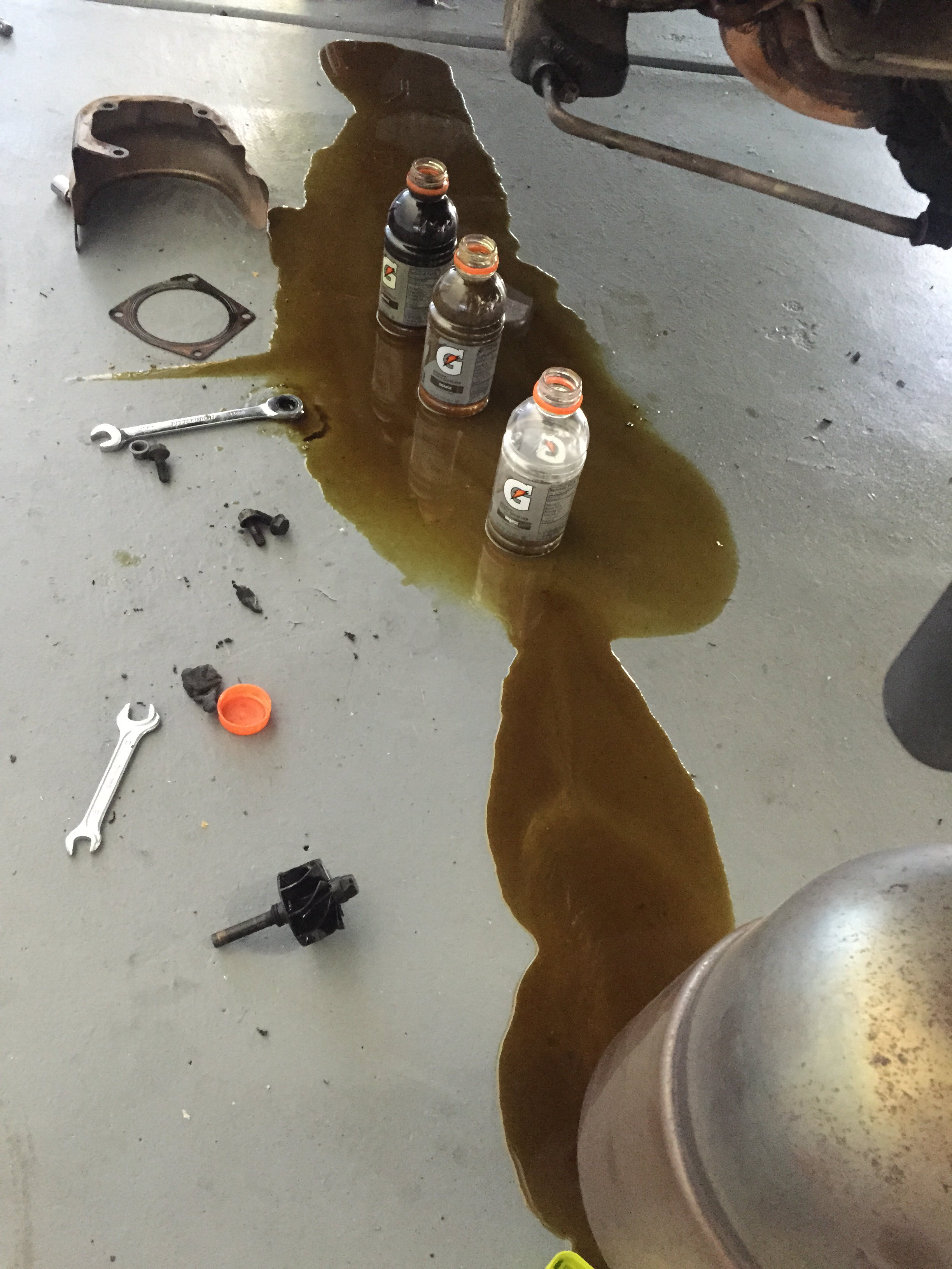

Finally had an opportunity to dismantle my car today. Two weeks ago at the track, I lost all power and had white smoke pouring out the back of the car on my 4th lap.

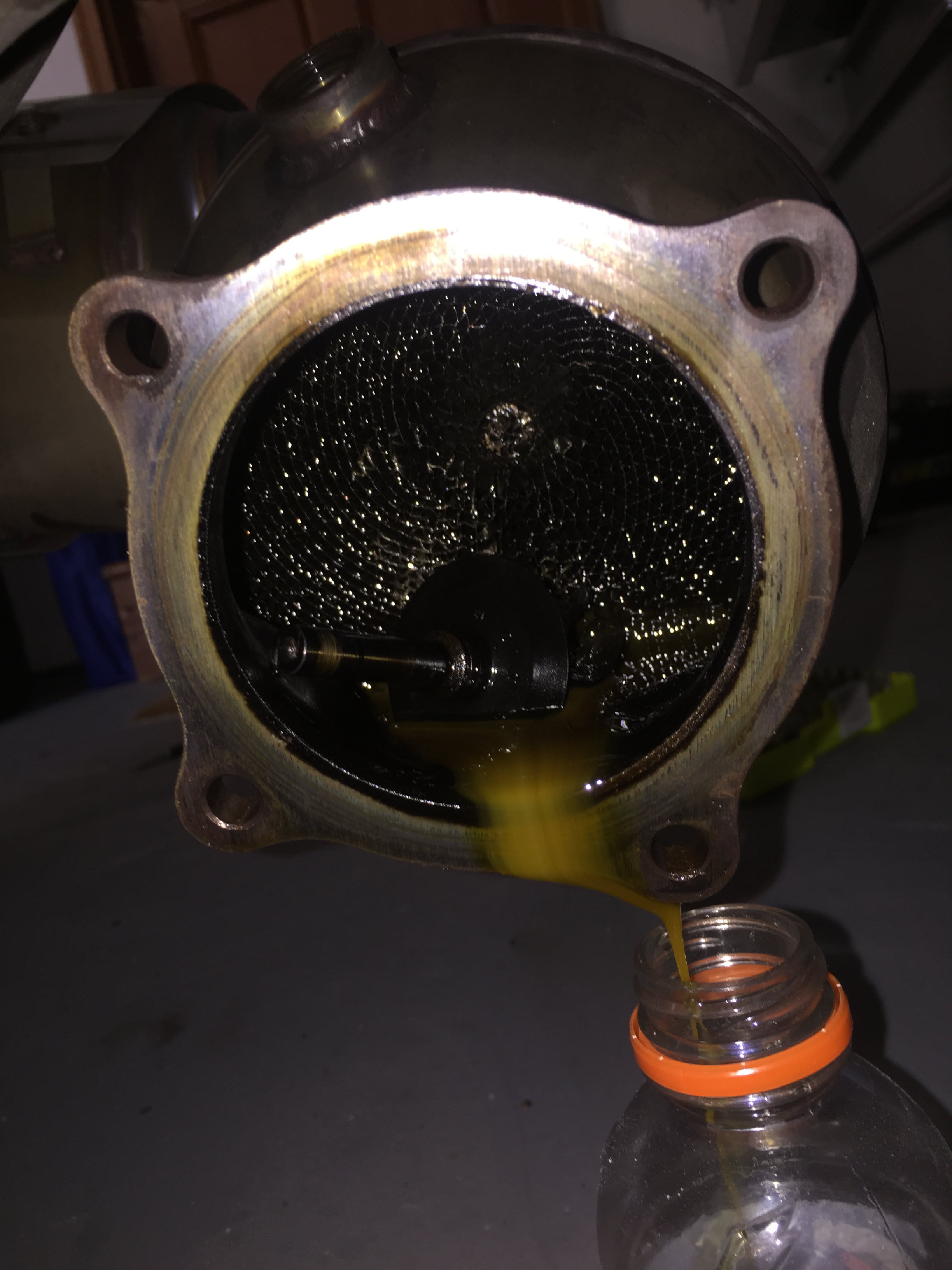

After removing my exhaust, it was apparent that the compressor wheel broke in two, one shot against the Cat convertor and the other just wedged itself into the turbo housing. Thankfully it didn't shatter causing engine damage.
Exhaust system filled up with 3 qts of oil.
Also, one of my "Forge BRV's" were completely seized up and the other with a very slow response. These are complete garbage!
So my questions,
1 - Is this a common VTG failure?
2 - Is the exhaust a complete loss?
3 - Since I track my car, what new setup should I be considering. Do the VTG's operate to hot for track usage?

Old Oct 25, 2015 | 08:52 PM
The Bogg's Avatar
Joined: Sep 2009
Posts: 2,658
From: GTA, Ontario, Canada
Rep Power: 236
The Bogg Is a GOD !The Bogg Is a GOD !The Bogg Is a GOD !The Bogg Is a GOD !The Bogg Is a GOD !The Bogg Is a GOD !The Bogg Is a GOD !The Bogg Is a GOD !The Bogg Is a GOD !The Bogg Is a GOD !The Bogg Is a GOD !
oh crap! sorry to hear that.
Since you don't have cores to trade in for another set of vtgs I would probably just get something like alpha 3073... Probably less high egts at the track with those.
Good luck, and post what you decide to do.
...and most likely the reason why you fried a turbo. BOVs open = leak, turbos try to fight against it and overspin. These VTGs don't like that.

Your shaft broke. Most of the time when that occurs( and isn't from an oil issue,) it's due to too much rpm. That crappy forge riveter valve was leaking substantially and the computer just added more angle to the VTG vanes resulting in too much shaft rpm which amplifies the minute imbalances until the shaft flexes and breaks. It takes a LOT of overspeed to make this happen, and I'm sure the high usage duty cycle on the track is what did it in.

Ryan,
Very sorry to learn of your troubles. Sounds almost identical to what happened to me several years ago and similar to a situation recounted by Glen, HPR's track manager, that preceded mine so it's an event not unheard of.
My first question would be where did the oil that you lost go? Remember, oil is a liquid and is non-compressible if introduced to the cylinders in any volume. If it was sucked back thru an intercooler and into the motor, you may have bent rods (something has to give), created bearing problems and affected other internals. It should probably be carefully checked. We pulled my motor and did comparative deck height measurements - distance of the piston head from TDC to the edge of the sleeve - to determine if there was a variation between cylinders which there was. We also used a bore scope in to inspect the cylinders. Rods were replaced with Carrillo's and bearings with ARP products along with all the other stuff associated with doing a build and some "as long as we're in there" stuff like welding coolant fittings, new clutch, etc.
If the oil was sucked back thru the motor there's also a very good chance that your MAF's are fouled beyond cleanable repair. After getting everything rebuilt, I chased CEL's and DTC's around for almost a couple of seasons unable to pinpoint the cause. Even though the MAF's voltage tested within acceptable parameters, I finally replaced them mostly out of desperation and the problems were solved.
With regard to the exhaust system, everything in mine was so fouled it had to be completely replaced - headers, exhaust, CAT's, mufflers - along with the intake side - intercoolers, plenum, and turbos. I pretty much went with an Evoms 775 package since they ended up doing the build and then had the tune customized for my usage and situation.
I've had people tell me since that there really was no need to open the motor and everything would be fine but I certainly didn't want to go thru the trouble and expense of replacing all the bolt-ons and then have the motor grenade at a point in the future.
Anyway, I'm very sorry you have to go thru this. It's a troubling and expensive pita. It kept me awake many nights while we sorted things out and eventually made repairs. The good news is we eventually got it right, the car runs strong and I haven't had a CEL or thrown a code for a couple of years now. Give me a call if you want to talk - send me a PM if you don't have my number. Best,
