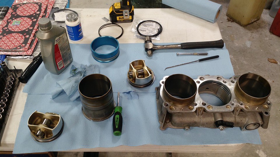

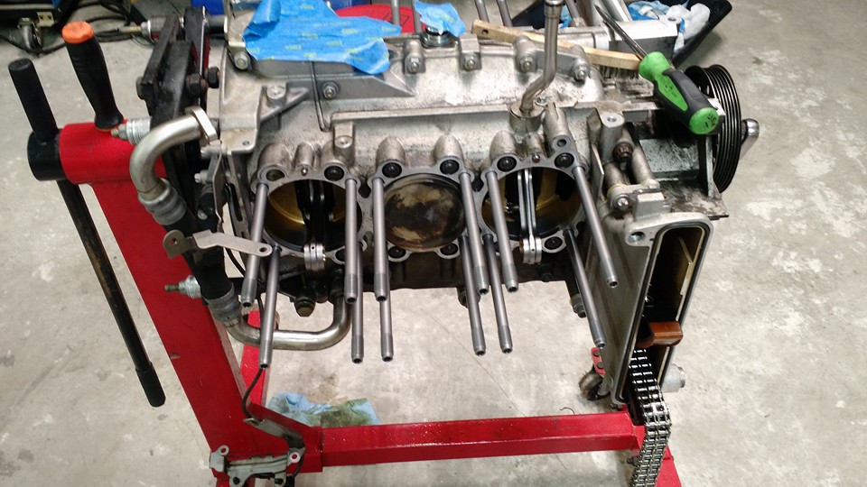

Pictars from tonight..
Any recommendations for methods for opening the holes in the base gasket for the 12mm studs?
Probably should make/buy a punch tool.. Might try a unibit..
Old Jan 22, 2016 | 08:42 PM
  #53
vr6tee's Avatar
Joined: Jan 2014
Posts: 379
From: Canada
Rep Power: 100
vr6tee Is a GOD !vr6tee Is a GOD !vr6tee Is a GOD !vr6tee Is a GOD !vr6tee Is a GOD !vr6tee Is a GOD !vr6tee Is a GOD !vr6tee Is a GOD !vr6tee Is a GOD !vr6tee Is a GOD !vr6tee Is a GOD !
I haven't done it yet but I'm expecting to use a tapered dremel bit, and slowly opening up each hole.
