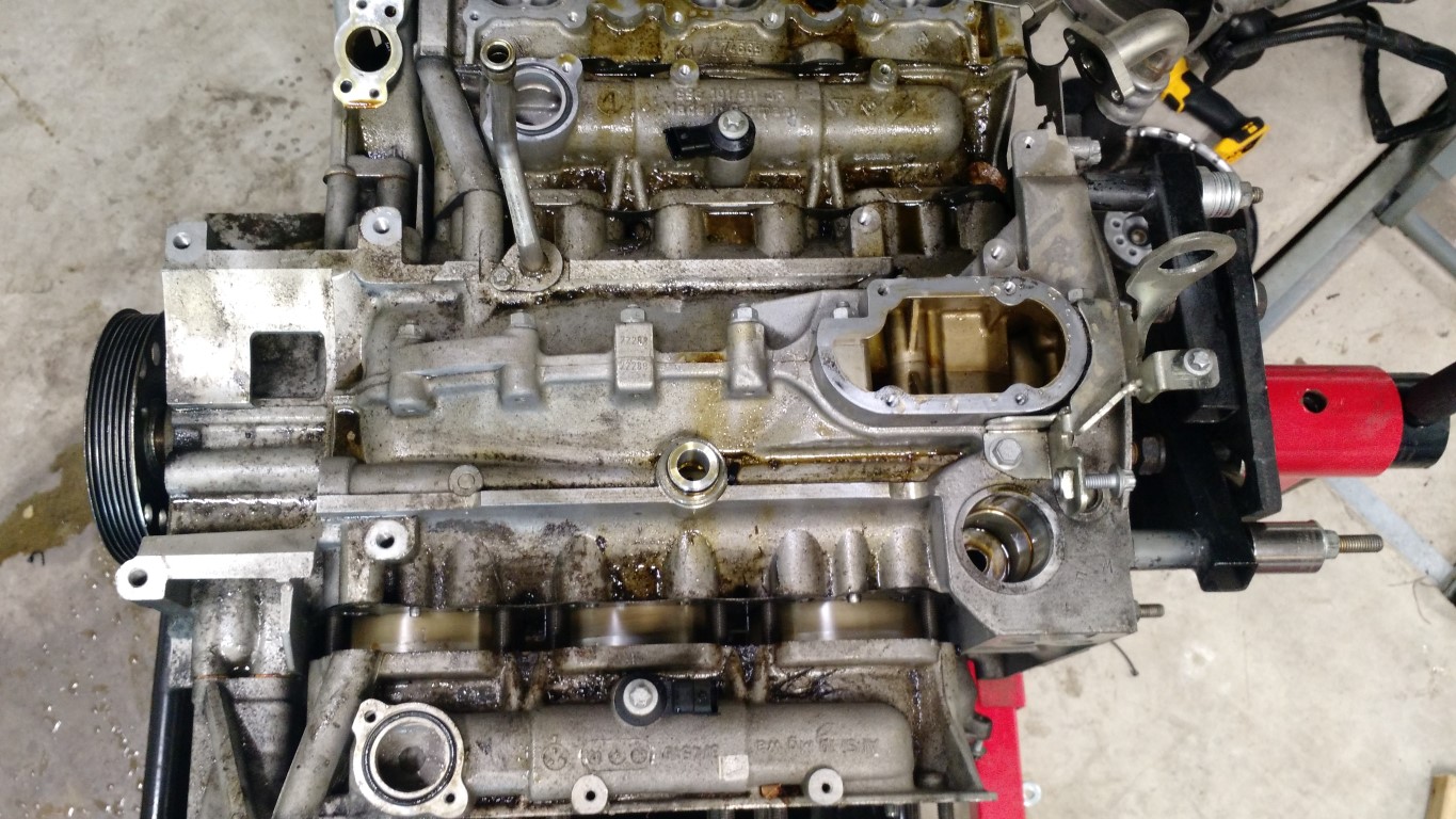

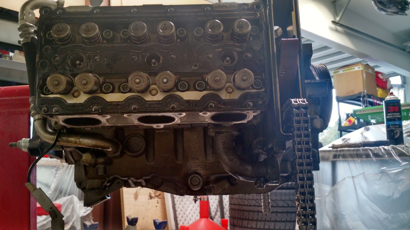

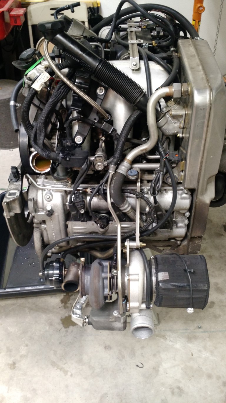

Another Round of mods (rods and goodies)
So last winter I swapped to 5558 precision BB turbos, sambTT's intercoolers, and proEFI tuned by Garth @ undercover.
This winter I am adding:
1)RPS triple clutch
2)GT2 slave conversion
3)Pauter rods
4)ported heads
5)mild cams
6) 12mm head studs
Ill have Garth back down to re-tune again. Car hauls *** right now (similar to Prodigy's car) but we have it dialed back esp at low RPM to make the rods happy. Looking forward to turning it up.
Right now motor is torn down to the pistons. Rough game plan is to start reassembly early Jan (cams are 6 weeks out).
More pics to come. Ill be gone for roughly 2 weeks late November, but I hope to start grinding on the heads before that.
Name:	IMG_20151101_152751578 (Medium).jpg
ID:	431864   Click image for larger version
Name:	IMG_20151101_152800410_HDR (Medium).jpg
ID:	431865   Click image for larger version
Name:	IMG_20151025_184246420 (Medium).jpg
