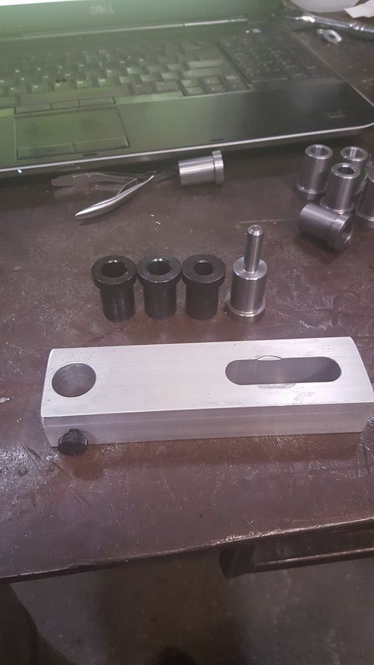

Thanks to an awesome jig from SRM I have the 12mm conversion half way done.
WOOT WOOT!!
Let me know if you have any questions, looks like ur doing just fine!

Originally Posted by itguy
WOOT WOOT!!
How does the jig work?

Pilot holes with a built in sleeve for the drill?

This was sour prototype, inserts remain the same, from right to left, locating pin, drill bushing, tap bushing, drill bushing (2)
We still recommend having the liner case and heads drilled on a bridgeport for accuracy but the case part is very easy with this tool.

Yup.. my cylinders/heads done on a bridgeport.. cases with this jig.
