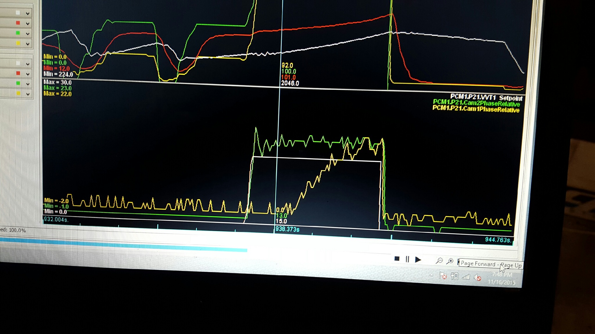

You can see here where my cam lags
It happens every once in awhile, but the ECU triggers a cut while it catches, so it can get annoying.
