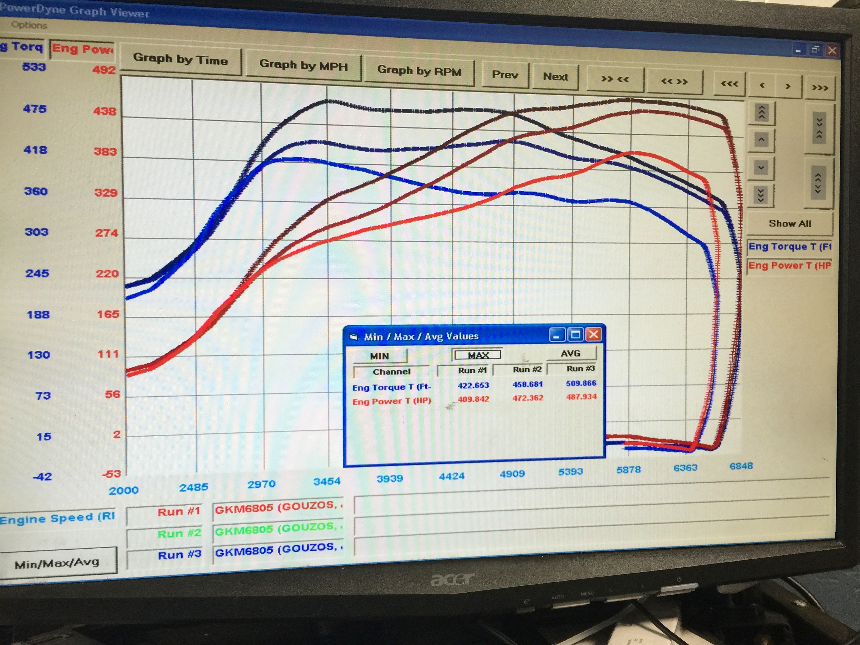

My old dyno .. Need advice on new parts
SubscribeI've posted pic of my last dyno.. I'm looking to install do88 inlet pipes... My question is that if I'm installing 82 mm idp plenum would anyone thing that plenum whould be to big for stock turbos to handle..Garth from undercover would be dialing in that tune so I know his going to be doing right by how the car is going to be dialed in..I also have 3 inch exaust and ams coolers with bmc filters ..it's on a Cobb 93 oct.. Custom tune.. What's everyone's opinions..

Btw these numbers we're run on mustang dyno..

I've ran ams coolers hard.. Garth was even impressed when we hot lapped the dyno back to back to back... Didn't loose that much power.. I really don't know how people can put 3.5 inch coolers on there car now when there's clearly better solutions out therezzOriginally Posted by prodigymb
