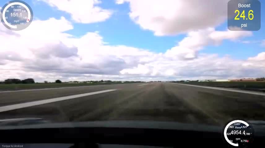

Yes...That could be. I have a Softronic tune and when I use my Torque App and BT OBDII Adapter, I get well over 20 psi...See below from No Fly Zone - Midwest. .Get your tune back!
DC
