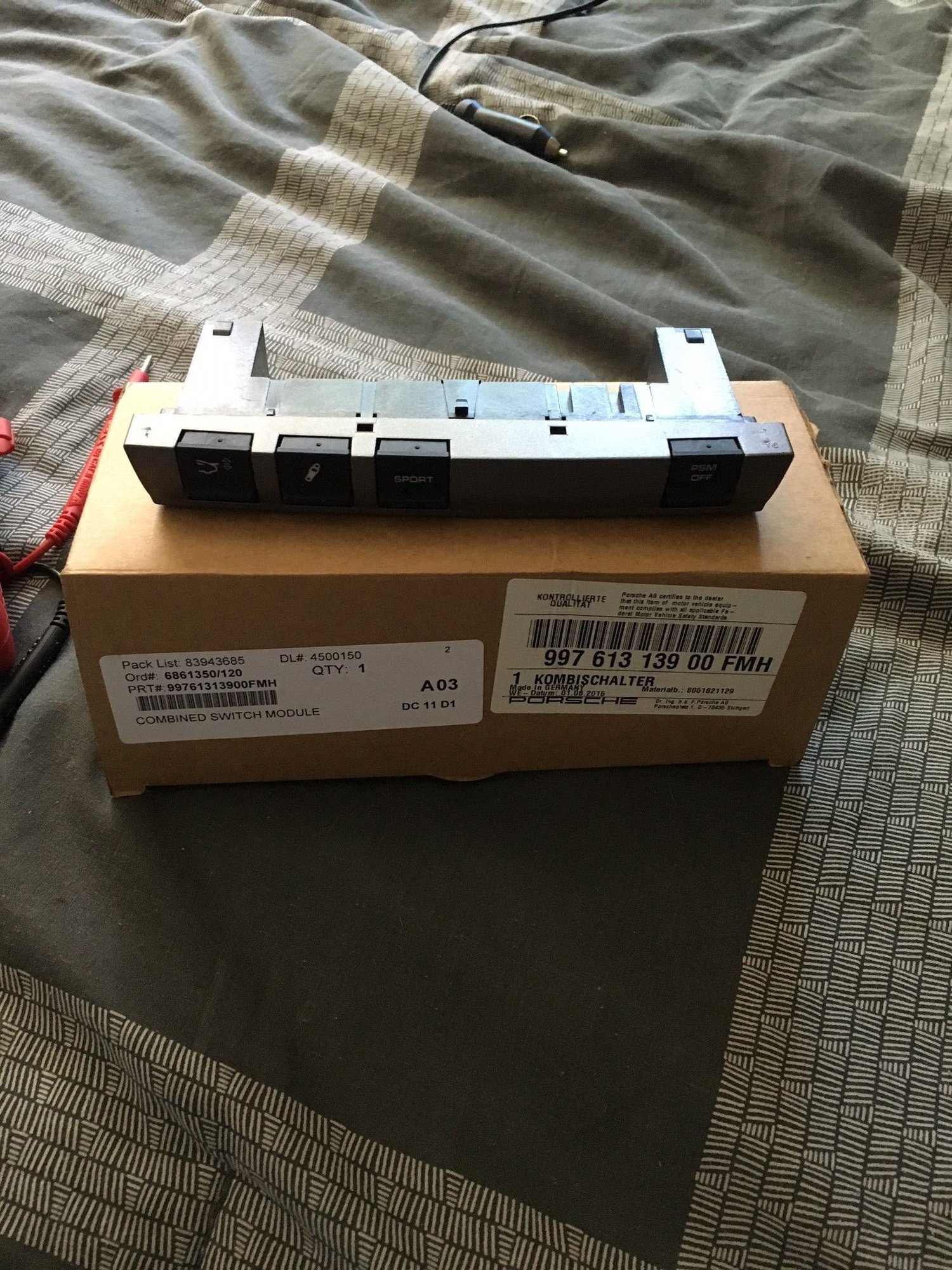

Problem fixed. It was just a bad switch module. $110 plug and play.

Chrono/clock always worked fine. Was able to track it to the switch module, seems to be a common GND that affects multiple momentary switches. All good now. Yes, car was located at Byers. Long way to go but I had a free flight/air miles. Hard to find 6MT Turbo in Atlas in CA. Especially with PCCB, locking diff, sport shift, and adaptive seats.

This is an old thread but I found it helpful when my sport button was recently intermittently not working in my 997.1TT with sport chrono. It was the "combined switch module" that was bad, just like SJFZ1's. The replacement was 130$ for the part through my local dealer.
I just wanted to add a quick note about the actual DIY replacement- someone will likely find it helpful in the future. The part simply pulls directly out. It is held in place in the console by metallic spring clips on each side. You don't have to take anything apart from the console or take any trim off- the part simply pulls straight out with a small amount of manual force. Once you pull it out, simply disconnect the wiring harness from the back of it, plug it into the new one part, and slide the new part back into the console. It's really quite simple and takes 10 minutes, or less. My wiring harness clip was a bit stubborn to get off, so the replacement took me 10 minutes instead of 2 minutes!
