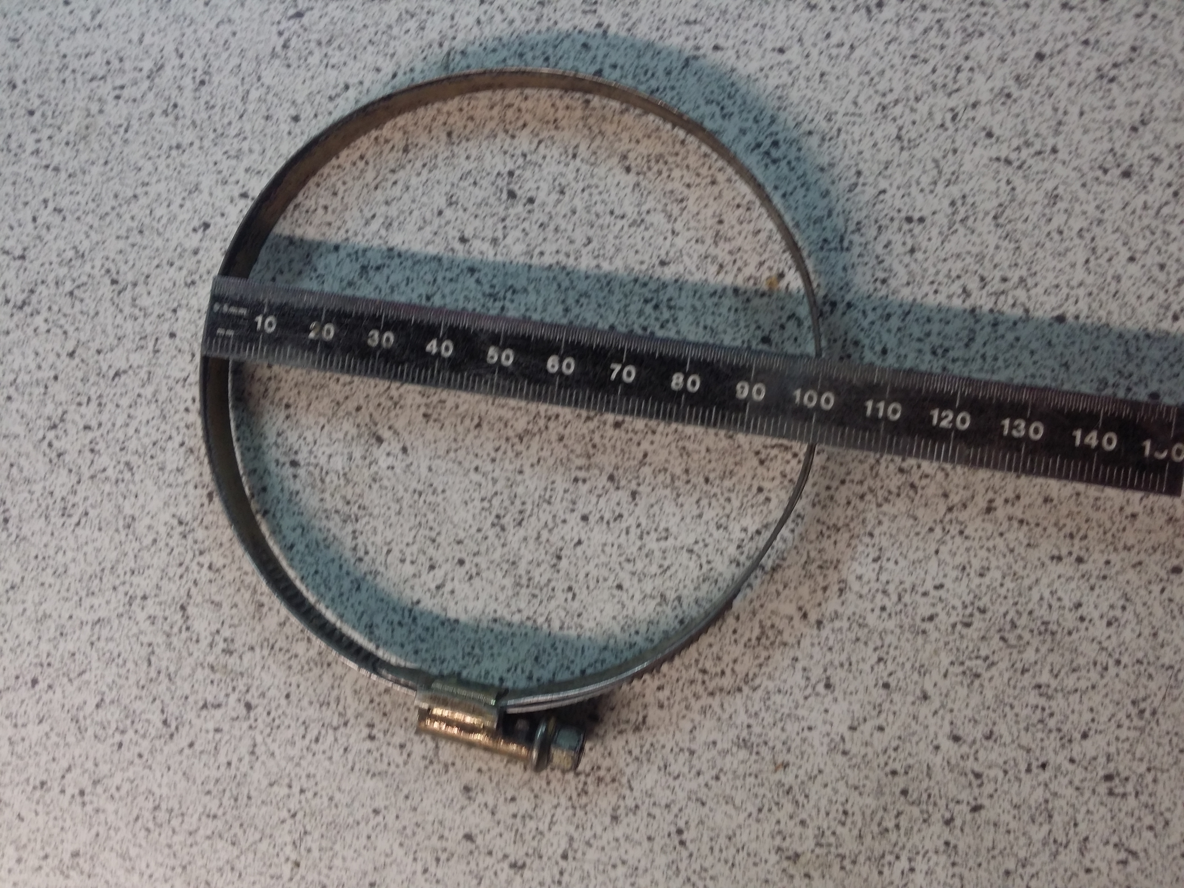

I haven't changed those 4 yet so let me know how the sizing goes. And yes they do split apart.

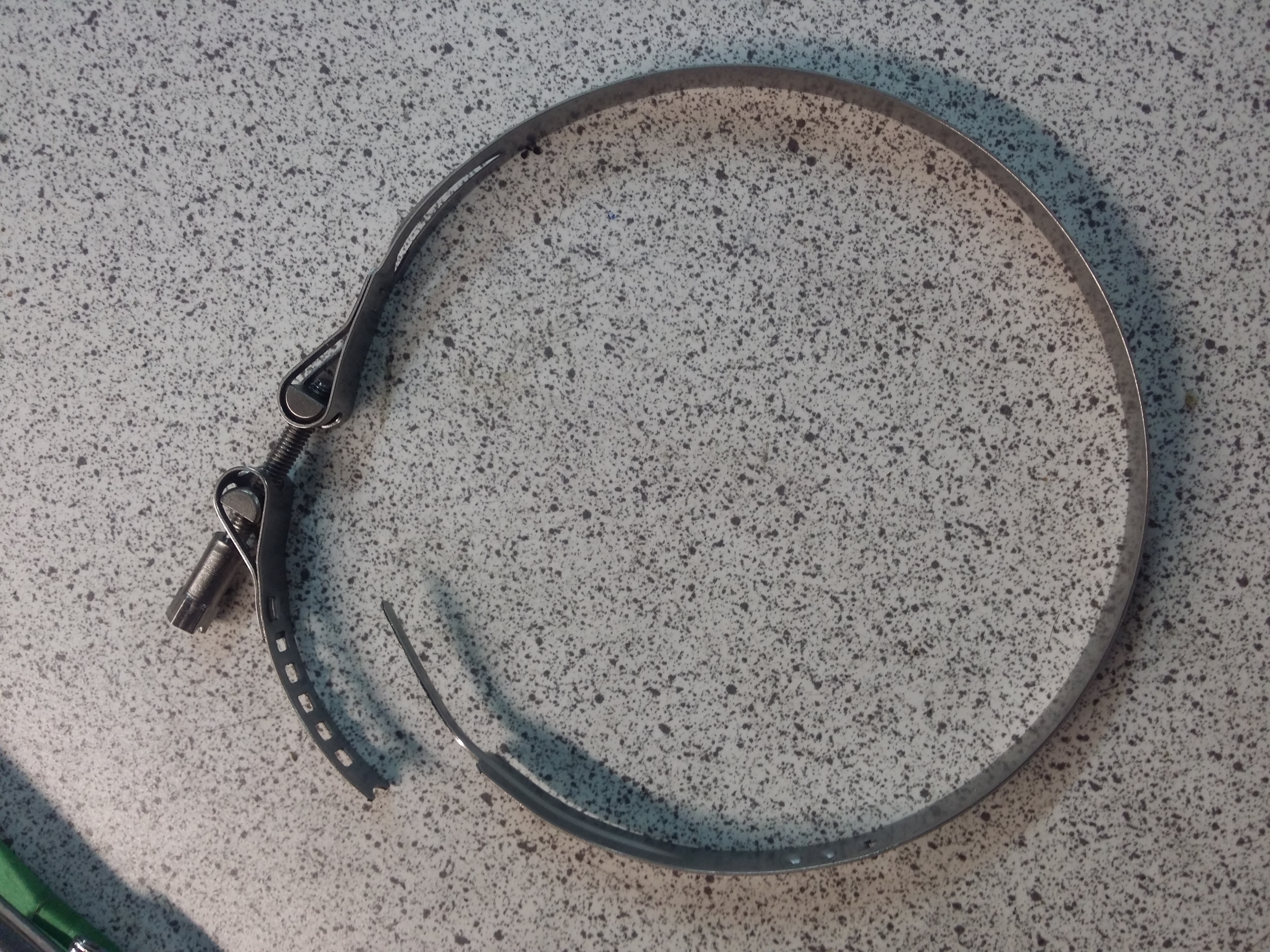

I tightened up a Norma 90-110 to about the same size (~40mm of tail) and it measures about 100mm across. The 95mm Oetiker I have is too small (the size is the max size). I'd guess the 105-9 Oetiker clamp is needed.
A nice feature of the Oetiker clamps (among many) is the lack of the screw housing. That section of the coupler gets rather deformed using the Norma clamps.

I bought 5 of the 105-9 Oetiker clamps for about 50 bucks delivered. They are pretty neat and would probably work great when used in a location that had good access. The plenum hoses at the back of a 997turbo engine are not that location, lol. I can't tell you how much swearing, sweating and body contortion was involved in order to get the sonofagun clamp on but I finally did it. I don't want to admit how many hours it took. Mainly because of the nature of this clamp - you need to align the end in a groove, the part is rotatable and you only have 2 hands.
As it turns out, the original clamp didn't "fail" - it must have been slightly too tight. When I slightly overtightened the oetiker I was astonished to watch it slowly wiggle off the rubber boot that it was clamping. I checked and I hadn't left a piece of the clamp on the lip or anything. Anyway, after more cursing I tightened it just enough and then left it for a day. Then tiny adjustment. Then left it alone and so far no boost leak. Car runs great. I have 4 spare Oetiker clamps because there was no way I was going to change the other ones after the nightmare of the first one. This is a good project for when your engine is already down getting other work done, lol.
