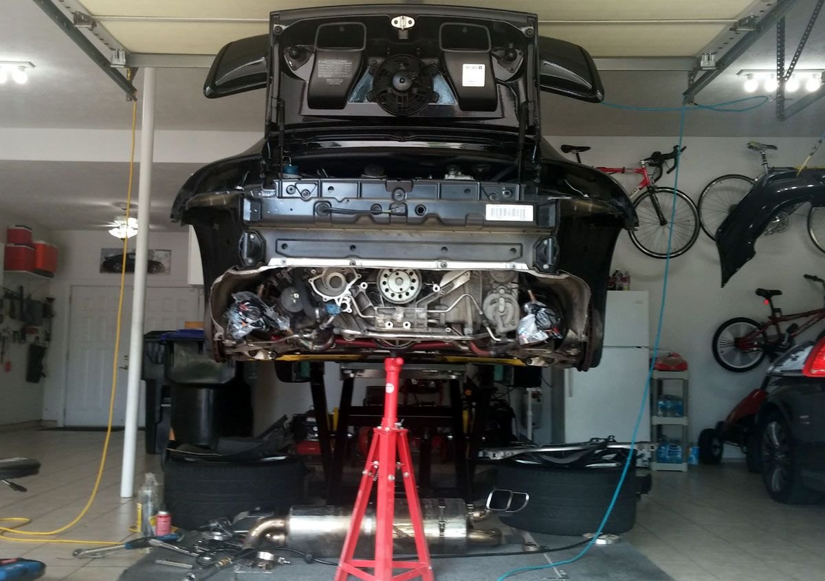

Well...Was going to beef up the car a bit to get ready for the next no-fly-zone..On the way home from work....I started hearing a noise from the engine compartment....Sounded like maybe the idler pulley or something....

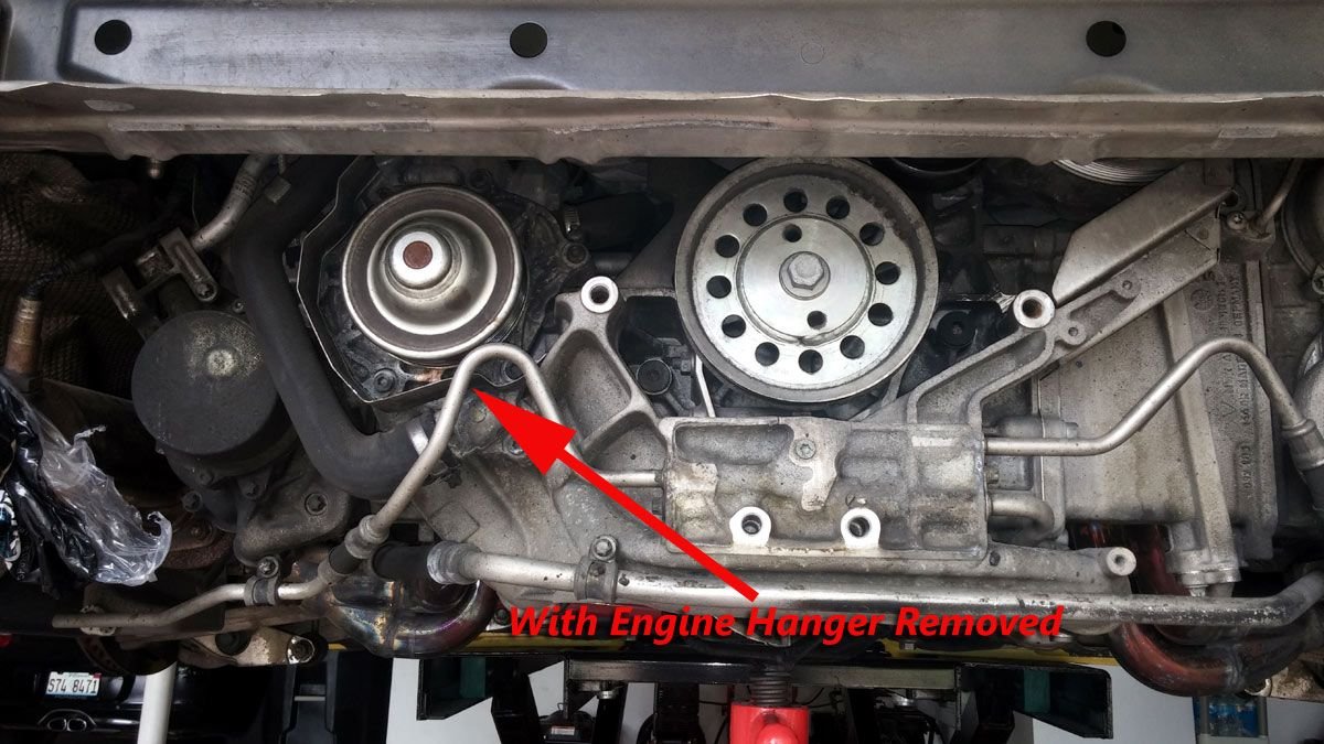

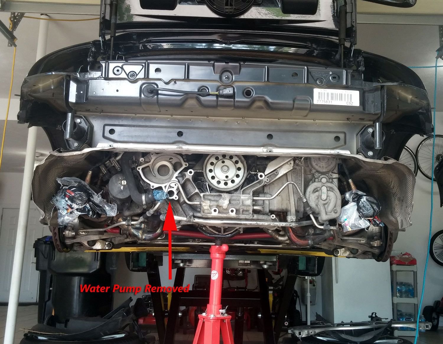

So I started taking it apart and listening and as luck would have it...the water pump! I ordered the part, and also changed plugs and a bunch of other stuff while I had/have access...pump should be in next week, and went ahead and got both idler pulleys while I am at it....Changed Plugs, Oil, and various other items including new silicon boost pipes...
Attached pics of the water pump for reference. Once you make access for yourself, it is not bad. I would hate to try this with engine in place
May put a DIY after done if I have time and if any interest....
