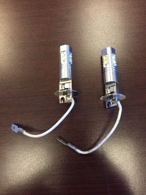

Here is what I received from Maxspeed. They do not fit.
Does this look right to you ?

bulb pics above ^^^

I recall mine looking pretty similar. I don't remember install being difficult at all - hardest part was getting the stock bulbs out.
The Maxspeed ones are no brighter than OEM (in fact, dimmer I'm sure). It they color match nicely with the HIDs and driving lamp LEDs I installed.

these are too long for housings.. so much in fact they started scratching the reflective housing so I abandoned ship. Not really worried about bulb intensity looking to match stock HID
