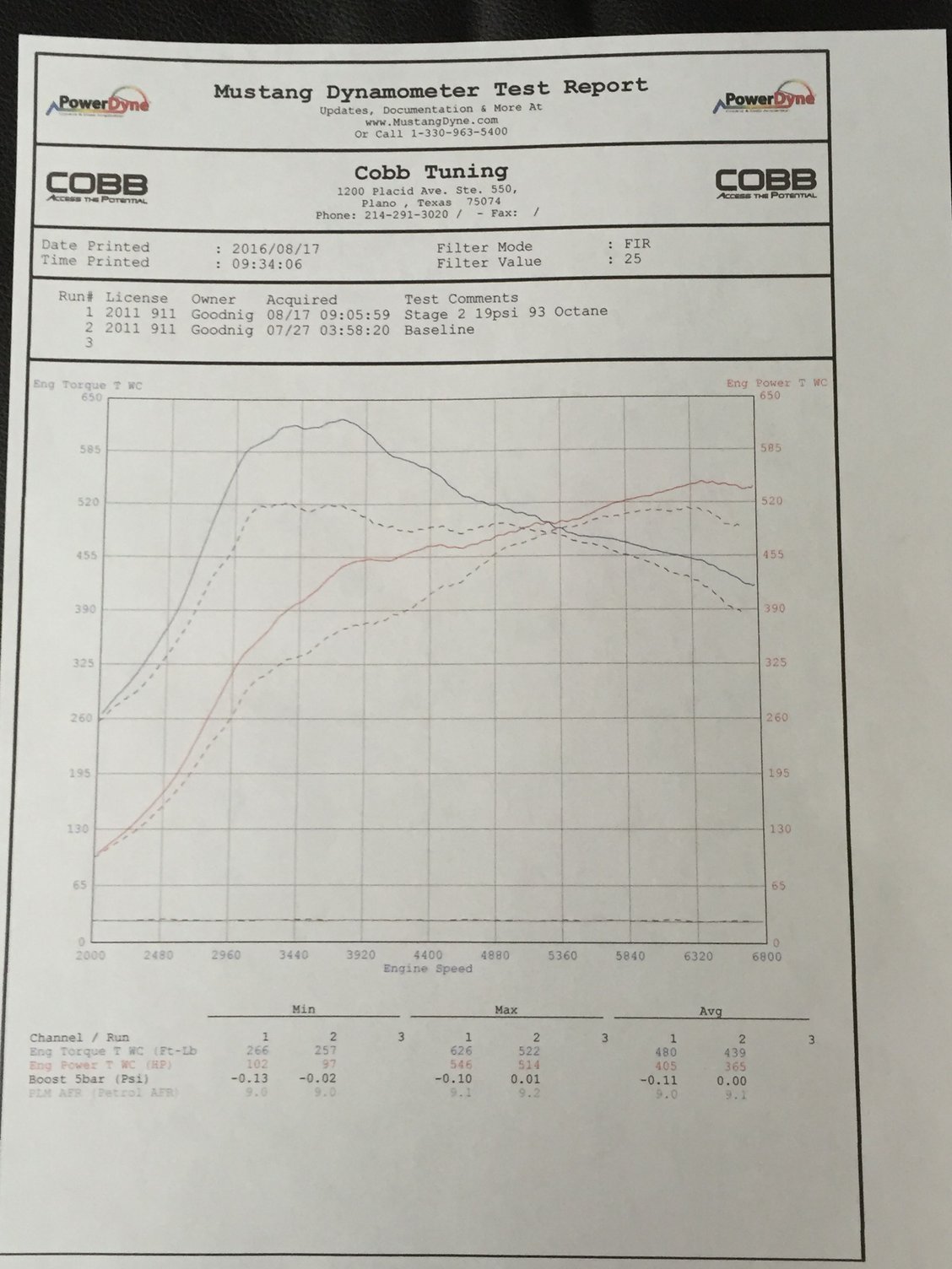

Ok... brief history here. We bought a new to us 2011 TTS back in July oh last year, with a Europipe and Sporttec tune installed. We took the car to Cobb Plano shorty after buying the car to have it dynoed. Car made decent power, but we wantred a custom tune... post tune the car made 546awhp and 626lbs/ft of torque! Started drag racing it and times were pretty good, not great, but not bad. Best pass was a 10.98 at 129 mph. Wife's best pass was 11.57 at 130mph!!! In the hot Texas heat in August/September l
Fast forward to this past week. We bought new AMS I/C's and had another tune done at Cobb Plano... car was baselined again BEFORE the new I/C's were installed. (I'll upload the dyno graph)
We took the car to back to Ennis yesterday for our first run of the season at a test and tune post I/C's and new custom tune installed. Weather was amazing with negative DA and cool temps so I was expecting great times from the car. My first pass was a 10.74 at 128 mph... decent et but mph was waaaay lower than I expected it'd be with new found hp and torque. My wife's pass was what piqued my curiosity though. She ran an 11.13 at only 126 mph. She had ran consistently 129-130mph last year, now it slowed down this much? Not saying the tune is the issue, but does it seem on the low side based on our numbers? I think it does.
SIDE NOTE... Yes, I KNOW I RED LIGHTED!!! The guy next to me took forevvvvvvver to stage and I let my frustration get the best of me. Besides, reaction time has ZERO to do with et or mph. Opinions welcome. My pass
Wife's pass

Hey Lawrence! So if i understand correctly, before the intercoolers you made 546 whp and 626 wtrq. But looking at the dyno graph you posted it shows a baseline of 502 whp and 609 wtrq. Then the new numbers with intercoolers and tune are at 545 whp and 634 wtrq. If so it seems you were right back to the same numbers previously. Was a boost leak test done before and after installation of the intercoolers?
Yes sir, you understand correctly. According to their new owner, former GM... they had their dyno fully rebuilt from the time I had my car custom calibrated last August to now. It supposedly reads much lower numbers now.. obviously from my newly posted dyno sheet it does. Like 40plus hp lower.
As far as checking for boost leaks, they actually broke the plastic inlet pipe ring on installing the new I/C's and epoxied it until we get replacements. Initial dyno it blew the boost inlet pipe off under full load. 😖 Anyway, to honestly answer your question, I can't say I know for sure they did post I/C install. According to their assessment, car is solid on dyno and road tests.

Here's the dyno from last August... after purchasing Access Port and having the car custom calibrated. The dyno has since been rebuilt resulting in lower numbers.
Ah that makes more sense. I am not 100% but i think i read somewhere that the updated lower intercooler hot side hoses are only available for the 997.1 models. But Sam would know best. Either way, i have a few of the plastic rings left in case you want to have some spare ones for a rainy day. Let me know.
