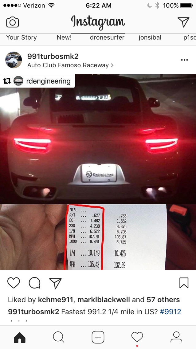

Just as an update, the 991.2 that I raced in race #9 just went 10.1 @ 136.X at Famoso on Saturday. The car was completely unchanged from our race at NFZ 7 days prior.
Our race was terrific dead even launch and my 997.2 pulled hard on this car which I believe fully supports my car's ability to achieve a 139.X trap speed in the 1/4 mile.
that 60ft was awesome !
