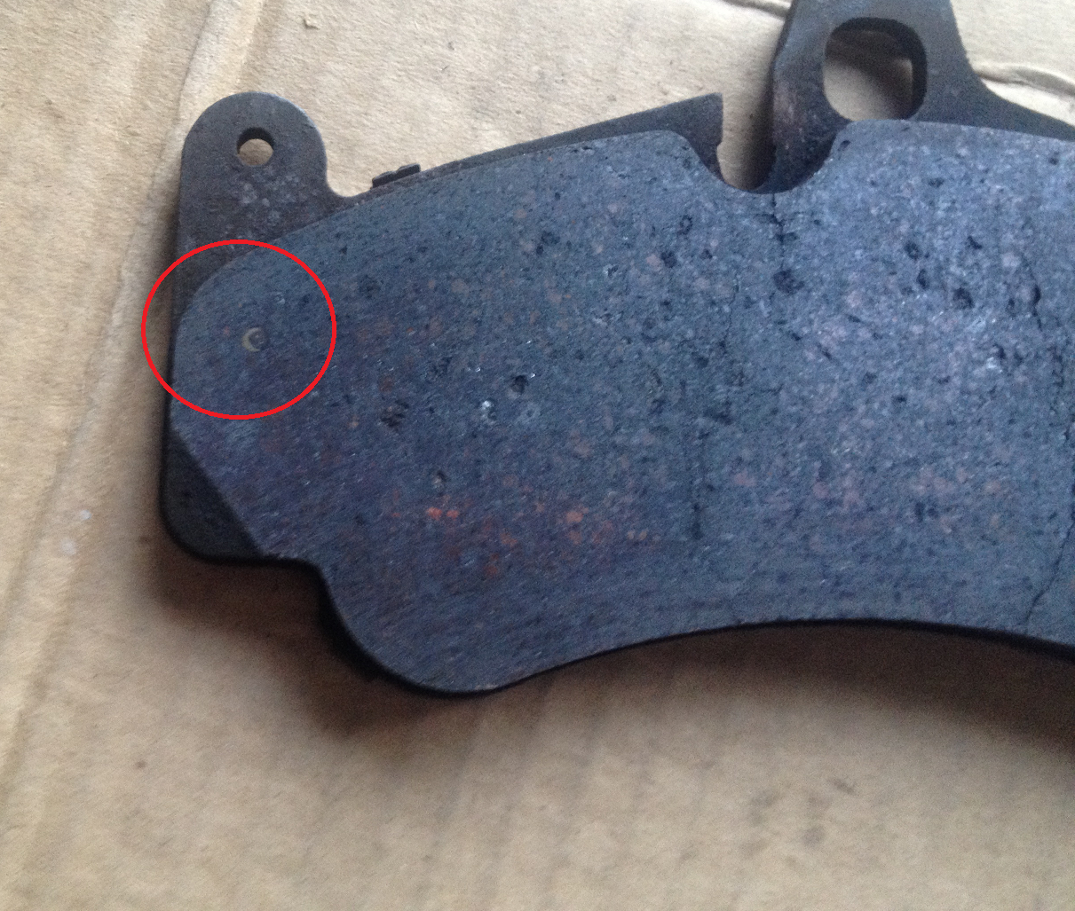

Hey Dave! I replied to your other thread regarding actual measured thickness.
I don't see how 2mm is possible because one of my PCCB pads was showing a copper rivet at ~4.5mm thickness. Also, at least for me, the outer and inner pads wore differently so definitely pull the pads out and verify both.

Thanks Johnny. I too think 2mm sounds a bit slim as a "change the pad's" tolerance. If the chart is saying 12mm new and change at 10mm, which is -2mm I'd be very confused. I have a CPO car that was inspected about 200 miles ago and the CPO says my brakes are at 80%. When I measured them, they were at 9mm or better on thickness. As previously mentioned, my "Brake pad wear" alert came on but, I see no way that at 9mm thickness, it's time to change the pads. Strange Porsche mystery here.

That definitely makes sense that the dealer is telling you 80% since you have 9mm of 11mm which would be about 80%. That being said, I was at 85% on my front pad at the top but only 35% at the bottom where the rivet was exposed...
