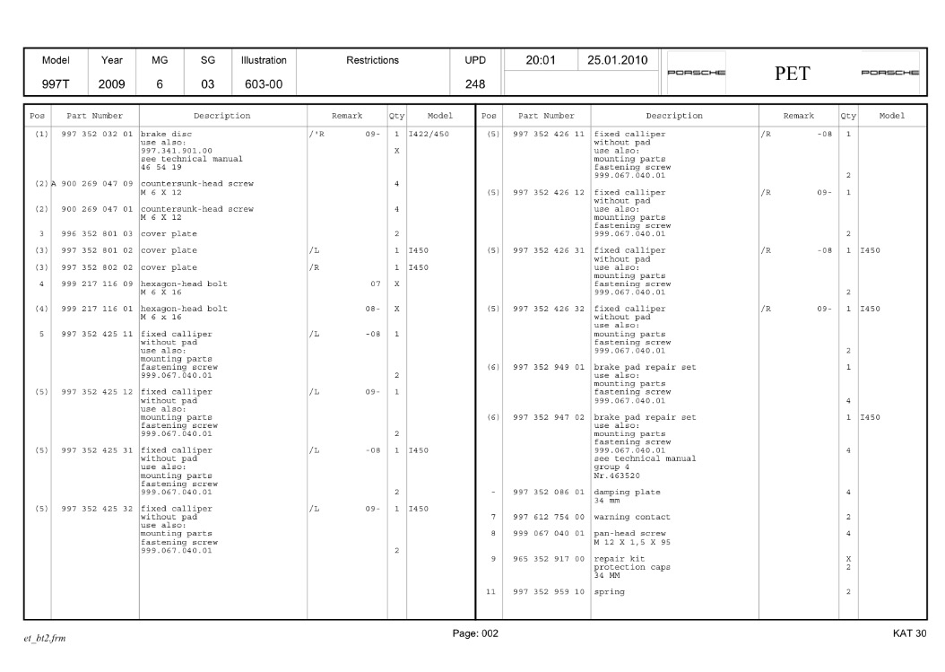

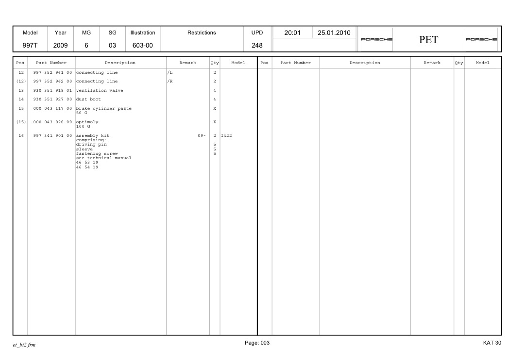

So I've had the brake pads for some time but the whole month of August I was traveling for work. I need to get the rear caliper bolts. Does anyone know the part number?
Old Aug 25, 2017 | 04:13 PM
nzskater's Avatar
Joined: May 2014
Posts: 401
From: New Zealand
Rep Power: 146
nzskater Is a GOD !nzskater Is a GOD !nzskater Is a GOD !nzskater Is a GOD !nzskater Is a GOD !nzskater Is a GOD !nzskater Is a GOD !nzskater Is a GOD !nzskater Is a GOD !nzskater Is a GOD !nzskater Is a GOD !
Assuming steel, item 8 on this page.
I've got ceramic
