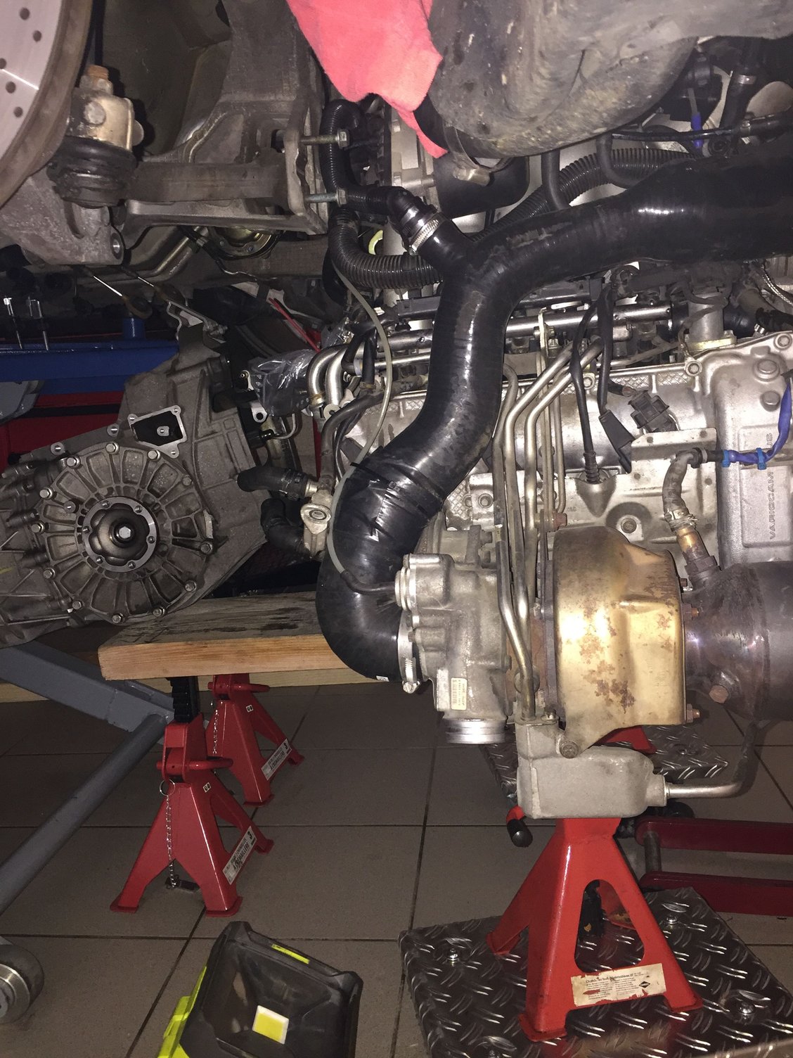

I just did both on my 997-1 TT, easy job when the engine is out of the car (or the car above the engine).

As you can see, it was necessary , they poped out just by pulling those two

6-7 hours the first time you lower the engine being carrefull
1 hours the cluctch job with the engine down
2-3 hours the pining only as there are some stuff to remove in order to access some spots ( there are 7).
