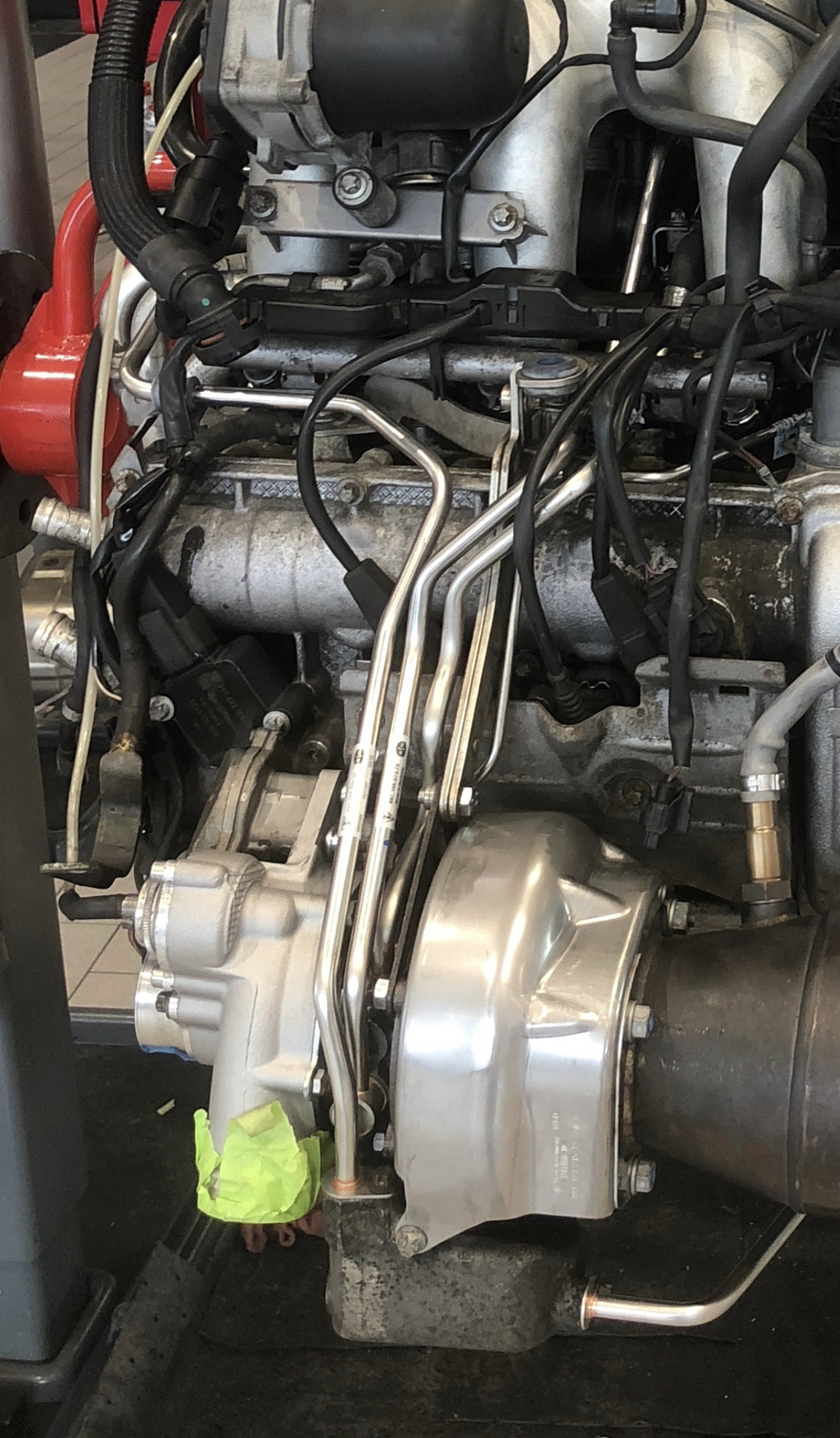

When I asked about actuator adaptations the other day everyone said they aren't necessary.
Here is a pic of where those lines run. It looks difficult with engine in.

Thanks for the heads up on the actuator adapations.
Looks like it will be a while before I find out looking at that picture of where the lines go !!
Thanks for that, much appreciated, but it looks nasty for access. Maybe the engine will have to come out then..!

It looks like at least one (or two in fact) goes under the inlet manifold. I just cant see how I could get that replaced with the engine in the car?
