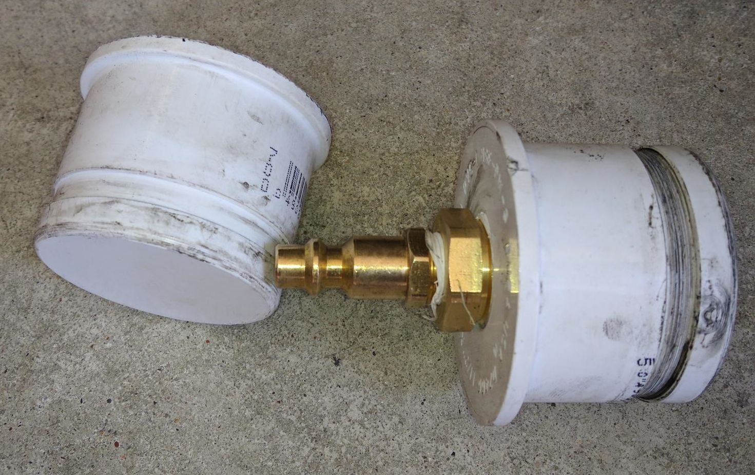

in the past I’d sent Markski just the brain box behind the passenger parcel shelf. He doesn’t need the car. But do try checking for a boost leak, that is always step one. There are instructions on making the tester out of PVC pipe, which is what I did. Take care though, they can pop out under pressure if not clamped TIGHTLY.

sorry..what you mean PVC pipes?the coolant pipes?

like this (not mine)
οκ..thanks..a lot...i will ckeck again tomorrow everything for any boost leak and i will let you know guys
