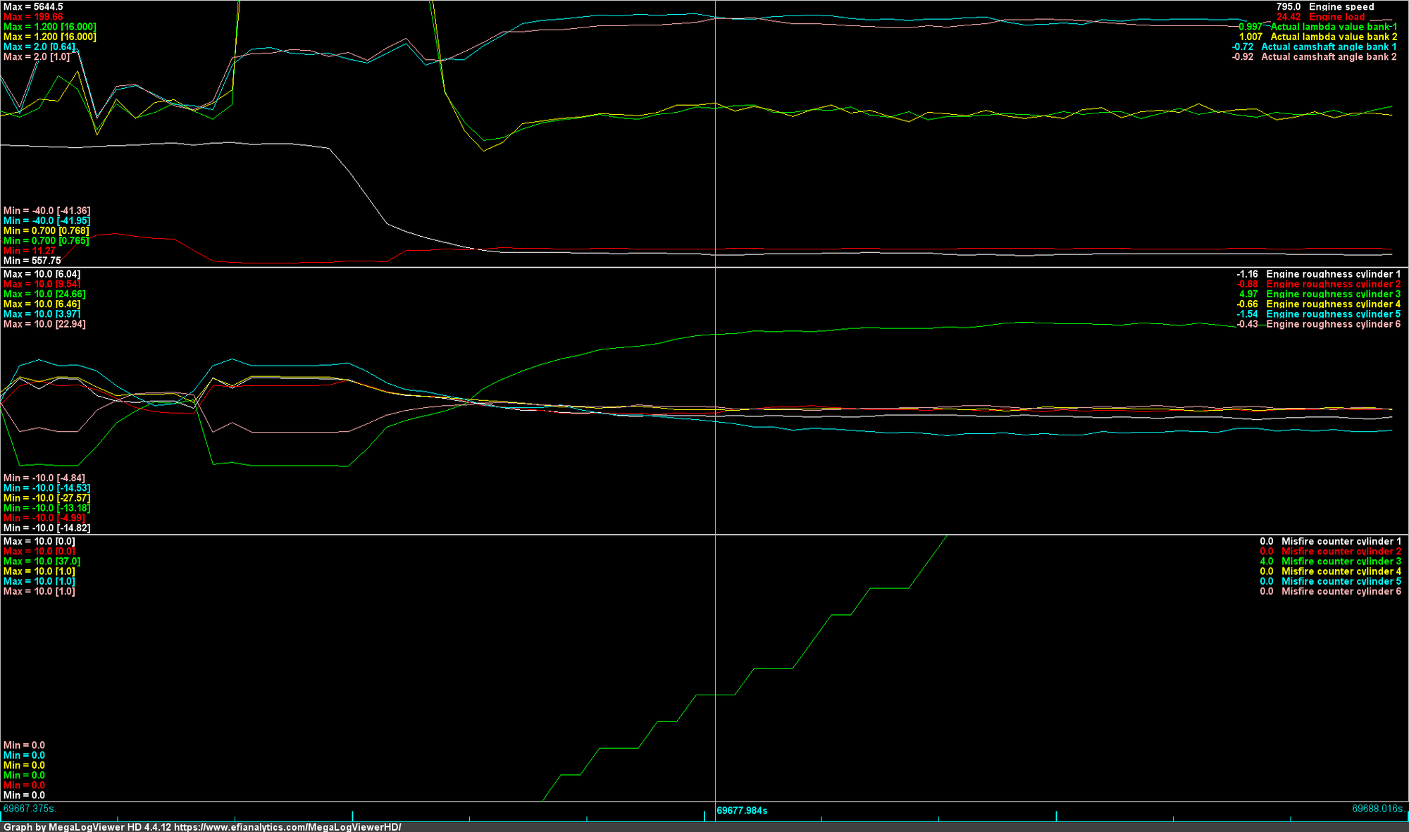

-Durametric shows anomalous roughness values for cylinder 3 / some misfires on cylinder 3 (intermittently up to count of 50, typically at idle, right after engine braking).
-Graph of roughness / misfires on all cylinders attached

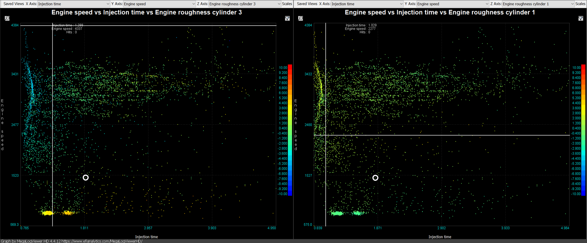

-Scatter plot of rpm vs injection time colored by cylinder roughness attached (cylinder 3 roughness vs cylinder 1 roughness for comparison)

-The correlation of negative roughness for cyl 3 during engine braking vs. positive roughness on cyl 3 during idle / with most roughness only occurring at low injection time seems potentially informative, but I don't have the expertise. Does this look like a simple issue of faulty coil/plug or possibly clogged injector? If so, should my next step be to replace coil/plug on cyl 3 (and likely on whole bank 1 while I'm in there)?

Log of roughness values on all cylinders, misfire counts on all cylinders, along with engine speed, load, lambdas on both banks, and cam. Cylinder 3 typically has a +5 roughness value at idle (other cylinder's absolute value of roughness is typically around 1 at idle). Cylinder 3 typically has a -5 roughness value during engine braking (other cylinder's abs roughness value much lower during same conditions). No codes, by cylinder 3 misfire count sometimes ticks up to 50 intermittently.
Scatter plot of injection time vs engine speed, colored by cylinder 3 roughness value (left) and cylinder 1 roughness value (right). Cylinder 1 roughness value is low throughout most of plot. Cylinder 3 shows high negative roughness at high rpm / low injection time, high positive roughness at low rpm / low injection time.

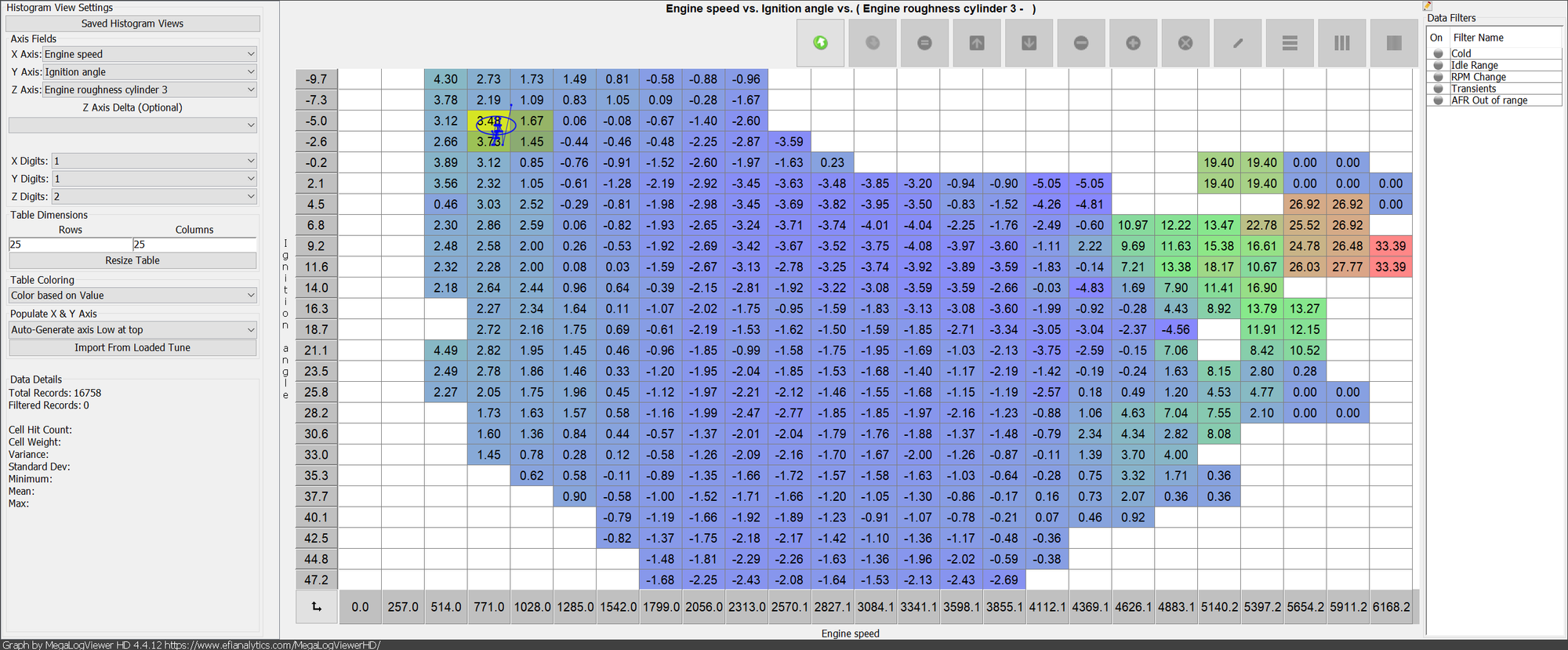

This might be slightly more informative: bucketed graph of rpm vs ignition angle vs cyl 3 roughness. Roughness does get a bit crazy on this cylinder at high rpm WOT (e.g. +33 roughness), but maybe that's not unusual (other cylinders also show their most extreme values at WOT and I see no misfires at WOT).
Right now I'm thinking most likely culprits in this order:
(1) coil / plug on cyl 3 are faulty (they did have coolant dumped on them about 2K miles ago. im going to inspect and replace when i find a spare 8 hours (lol) to kill)
(2) injector on cyl 3 is faulty (injectors are original, but i have run a couple rounds of seafoam / injector cleaner through the gas tank)
(3) burnt exhaust valve on cyl 3 (is this consistent with symptoms? or would i be seeing codes / bigger problems at WOT? how do I test this?)
(4) intake manifold leak near cyl 3 (how do i test this? brake cleaner on cyl 3 manifold while idling and check log for AFR changes?)
(5) DME wiring issue (have seen a case like this on a subaru EJ causing misfires on one cylinder. where is likely culprit for a wiring issue? at the coil? at the DME? anywhere??)
Anything else I should consider with higher priority?

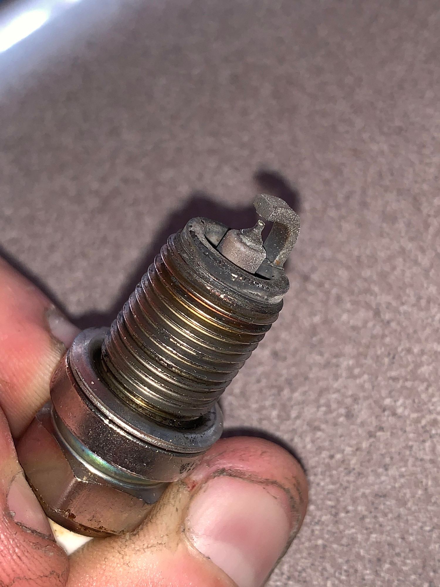

Well -- not without some trouble, I managed to replace coil and plug on cylinder 3 this past weekend. Unfortunately, no change in roughness values on cylinder 3 at idle. In fact, maybe slightly worse -- though possibly just temperature dependent or something. Now idle roughness for cylinder 3 sits at about +5.0. I've attached a picture of the spark plug I removed. What's next? Injectors I suppose? I still think the flywheel is a possible culprit. It is stock dual mass, replaced with brand new OEM part about 20K mi ago when I changed clutch. Any way to diagnose flywheel without dropping engine? Thanks for any advice!!!
