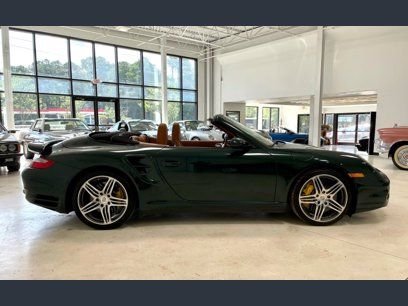

Yes it does. It’s a really well optioned car and one owner too.

Very nice set of options!
