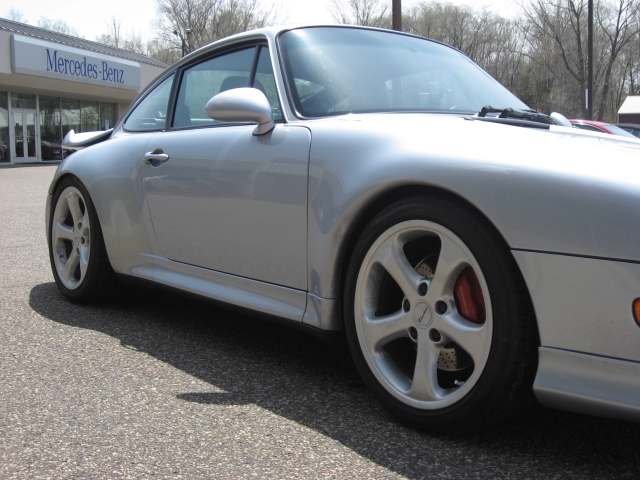

Lat, how about a shot of that 993tt rs?
Old May 14, 2008 | 06:07 PM
LAT's Avatar
LAT
Joined: Dec 2006
Posts: 105
From: Canada
LAT is infamous around these parts
Actually the shifter I like it was the car I had issues so I sold the 997TT and went back to an old 993TT.
More pics on RL "The journey home"
