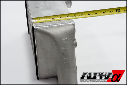

AMS/ALPHA Performance Porsche 997.1 Intercooler kit NEW LOWER PRICE!
EDIT: PRICE DROP TO $4499.95 Thanks to new more refined manufacturing process' here at AMS!
On the heels of our newly released ALPHA 9 performance package https://www.6speedonline.com/forums/...l-release.html we are proud to announce our new 997.1 Intercooler kit.

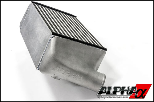

The Alpha 997 Intercooler System utilizes a pair of 5.5” thick, high volume cores giving you the most power producing option on the market. Each core provides twice the fin density (24 fins per inch) for unmatched cooling.

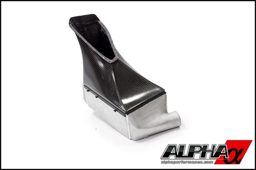

The kit also retains full use of the intercooler inlets (located in front of each rear wheel) forcing cool air into our larger, carbon fiber shrouds. Not only is this option more aesthetically pleasing, each rigid, OEM-quality, carbon fiber piece is made to seamlessly mate to the Alpha Intercoolers feeding them cooler ambient air more efficiently. Not to mention eliminating the need to remove or butcher your intercooler ducting like the competition.

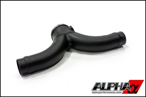

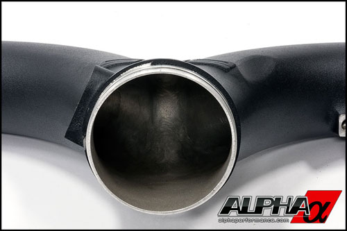

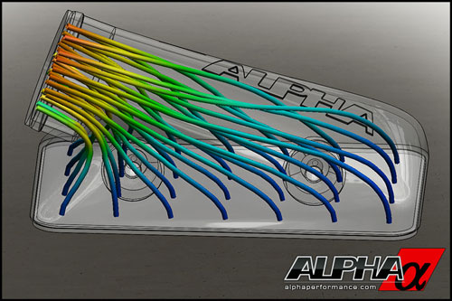

Another key component to the intercooler system is our computer designed intercooler piping. This features a cast aluminum y-pipe offering 40% more flow. The larger 2.5” diameter is significantly wider than stock (1.79”) and its cast aluminum construction allowed our Engineers to provide the best flow while conforming to the tight surroundings of the engine bay. In addition, our computer designed, precisely molded, custom silicone couplers provide perfect fitment and optimized geometry for improved airflow volume and velocity. All of this careful planning and design equates to unmatched power and response helping you stay ahead of your competition!
Alpha Performance 997.1TT Intercooler Kit Key Features:
  • Painless installation and completely reversible back to stock
  • 5.5" deep intercoolers with smooth flowing cast end tanks
  • OEM quality, retains OE routing and fits exactly like the stock system
  • No loss in boost response
  • High flow/strength 4-ply reinforced silicone intercooler tubing
  • 100% carbon fiber intercooler ducting, not glass with carbon fiber overlay
The Alpha Performance 997.1TT Intercooler kit offers you a complete solution with nothing left to buy. What makes this kit even more appealing is that it offers exact tolerances and fitment within the tight confines of the 997 engine bay. Not only does it improve the size and effectiveness of the intercooler system, it's is all done without deviation from the stock routing!

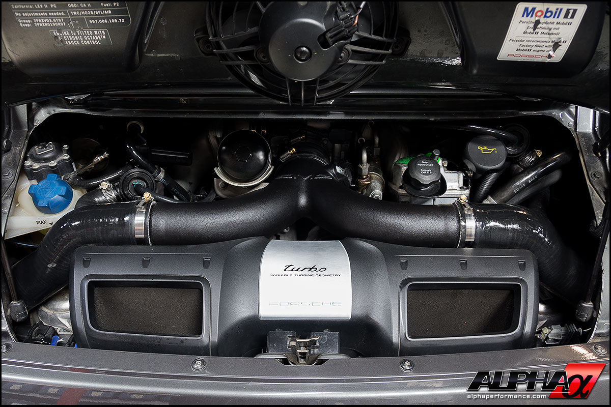

where do you put the BOV's? In the silicone hoses that connect to the Y Pipe?
can you share a pic of the engine bay?

Yes you are correct
We'll get an engine shot up tomorrow.

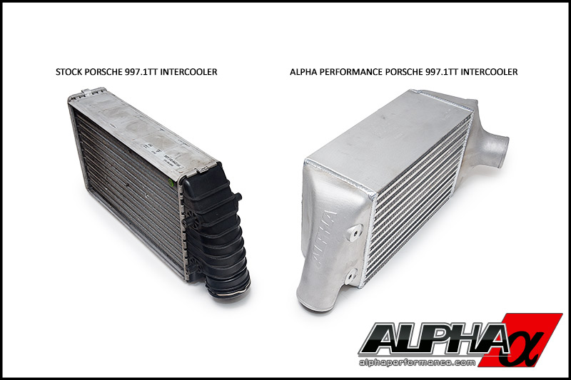

Here is the Alpha Core vs the stock core!
