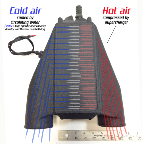

Can someone tell us how can we measure the temperature that comes inside the engine?
I saw that the maf sensor is after the K&N filter, before the vortech,so the temperature that measure is not correct,because it measure wrong.
The correct instalation in order to have a correct temperature that comes inside the engine is the maf sensor must be fit between the aftercooler and the air intake.
Am I right?
In some places,where the temperature is to high we will not have a correct measure,so is very dangerous to brake the engine.

DOCTOR 911s, please see the diagram of our Aftercooler below in which you can see the location of our IAT (Intake Air Temp) sensor with the wire coming out of it. We are measuring the cooled air directly before entering the motor:
Old Mar 29, 2013 | 02:11 PM

Can you tell me witch is the temperature that comes inside the engine when the temperature in the ambient is 140F?
Old Mar 29, 2013 | 02:14 PM

Where it goes the wire of the sensor?

I have carrera s 997 supercharger and after 5 times in the red line of the 3rd,4th and 5th gear with noon ambient temperature 90F I saw at the thermometer that it was between the watercooler and the throttle maximum 150F.
What do have to say about this?
Is it ok or I have to be careful in order to protect the engine?
