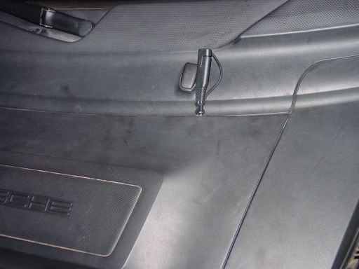

Every vehicle I own has one of these somewhere:
I had to remove about 1/4" of material from the lip on the back of the battery cover for the cable to slip through. It tucks up next to the windshield washer where you can hook it with your finger and pull it out, but it is not otherwise visible. Lots of good battery tenders out there, the Deltran unit is very solid.
PB
