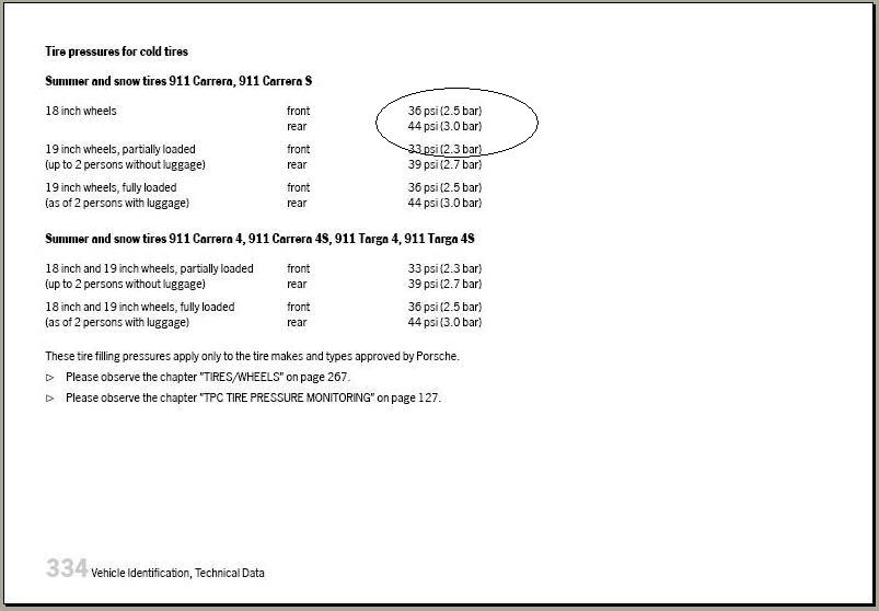

Hold on Steven - if your car has 18" wheels 36-7/44 is the correct pressure. Most people on the forum seem to have 19's or more and they run lower pressures. Relevant page from the owners manual attached.
I run mine at 37/44 with no problem.

actually i have the 19" porsche turbo rims...
Steven
Originally Posted by aggie57
Hold on Steven - if your car has 18" wheels 37/44 is the correct pressure. Most people on the forum seem to have 19's or more and they run lower pressures.
Steven
OK - nice!!
