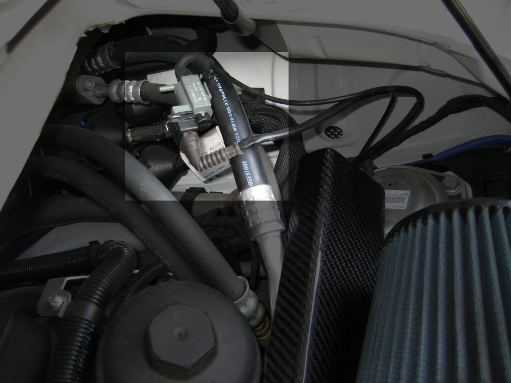

Fabspeed Motorsport's Avatar
Posts: 3,894
From: Fort Washington, PA
Fabspeed Motorsport Is a GOD !Fabspeed Motorsport Is a GOD !Fabspeed Motorsport Is a GOD !Fabspeed Motorsport Is a GOD !Fabspeed Motorsport Is a GOD !Fabspeed Motorsport Is a GOD !Fabspeed Motorsport Is a GOD !Fabspeed Motorsport Is a GOD !Fabspeed Motorsport Is a GOD !Fabspeed Motorsport Is a GOD !Fabspeed Motorsport Is a GOD !
Originally Posted by kiet420
I installed the Fabspeed Cold Intake on my '09 C4S about a week ago, the check engine light keeps popping up. I spoke with a tech from Fabspeed, he walked me throught the install, according to them everything is installed correctly. I remember the video on their site saying, "NO CHECK ENGINE LIGHTS." Just wondering if anyone else did this and has the same problem. Thanks.
Kiet420: The vacuum solenoid has to be reconnected or the C.E.L. will appear. See picture below>>

Originally Posted by luis@autodynamica
Probably you just blow the MAF is easy to over rev the car with the high flow intake and the sensor is very sensible

Originally Posted by lakerholic
What does this have to do with the price of tea in China? Who cares? It's his money and his car...
To answer the OP's question, though, unless there is something vastly different about the intake/air mgmt on an 09 versus 05-08, you may have inadvertently dislodged the MAF. Otherwise, it should be a straight 5 minute swap with no positive gains other than a slightly louder sounding intake...
I had the intake installed by the head tech from my local dealer, so I'm not really sure. He's gonna look at again once I talk to Fab again.
