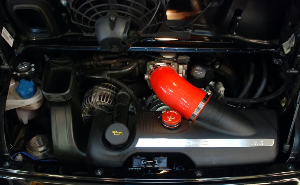

On the 997.1 Carrera/996 Carrera vehicles, our Cold Air Kit still utilizes the stock airbox. There are NO Check Engine Lights with this upgrade if used with the stock paper element or a BMC F1 air filter.

Question: there was a hose that connects to that open nipple on the same connectio that that vacuum line connects. There used to be a black hose that goes from that nipple to the old intake. It appears you have removed that hose completely. In my system, I have the hose attached to the nipple and the other end of the hose open and tied down to other wires out of the way. Can I remove the hose completely similar to your picture?
Originally Posted by Joey@fabspeed
Kiet420: The vacuum solenoid has to be reconnected or the C.E.L. will appear. See picture below>>
