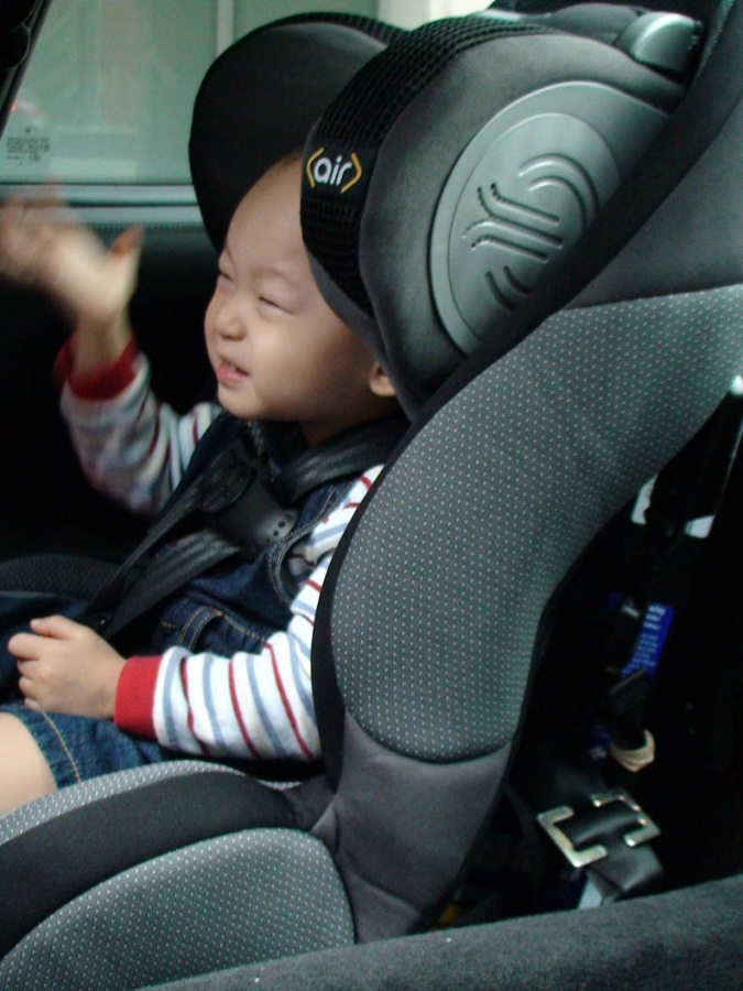

#4) The rear seat belt receptacle needs to be adjusted to face more vertical. This is because it faces forward originally and can not provide enough tension to hold the car seat back with the belt. To adjust you need to first remove the plastic cover at the base of the seat belt receptacle by pulling it off..it just snaps off. This exposes the Screw head that secures the receptacle. Then you need to use a SOCKET WRENCH to loosen the Screw Head and then rotate the receptable upwards. Then screw it back down super tight!!!
#5) place rolled up towel on the base of the rear seat for added support.
#6) install car seat as usual.
Quite secure in my opinion.

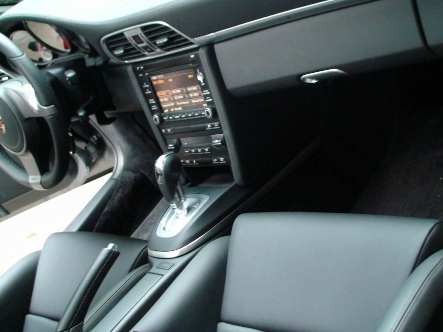

Note son is 20 mo old. He is 50%ile in height. He likes to put up his feet against the rear seat on the carbon fibre..but luckily i bought this tinted window sunscreen (for my other car) which also sticks well on the carbon back and protects it. Also, my son really like to be able to LOOK FORWARD through the GAP in the BUCKET SEATS so he can see ahead (when there is no one in the front passenger seat).
