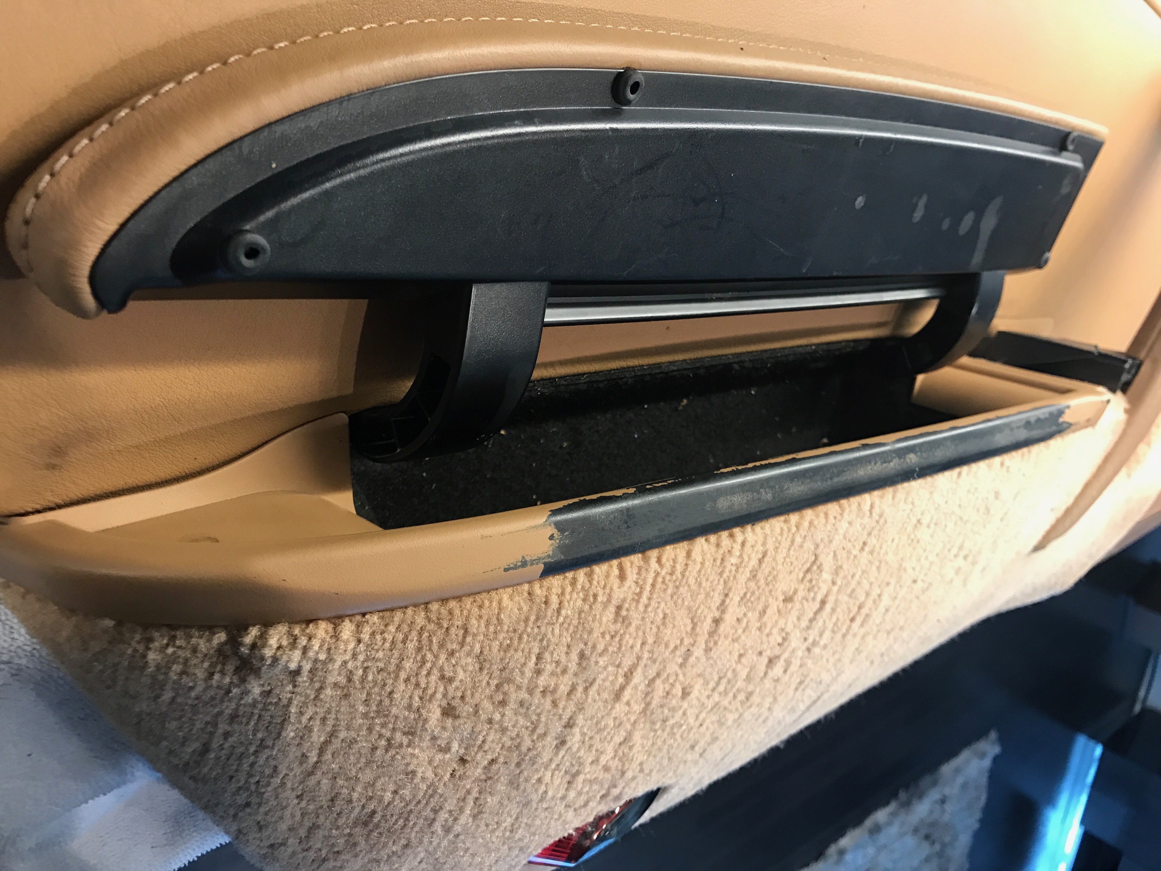

Has anyone figure out how to remove these? thx

It requires door panel removal. That's the way to do it safely

doors are removed but it makes no difference

Sorry, I misunderstood and thought you were trying to remove the door armrests...duh. The trim piece you are referring to cannot be easily removed. It isnt secured by any screws or plastic rivets - I think there is a strong adhesive that holds it in place. In your case I'd mask everything up and use a flat black spray paint (or if you can find a suitable dye, perfect) on that piece when the door panel is out of the car. I believe that if you try to remove that trim piece you will end up destroying it in the process.

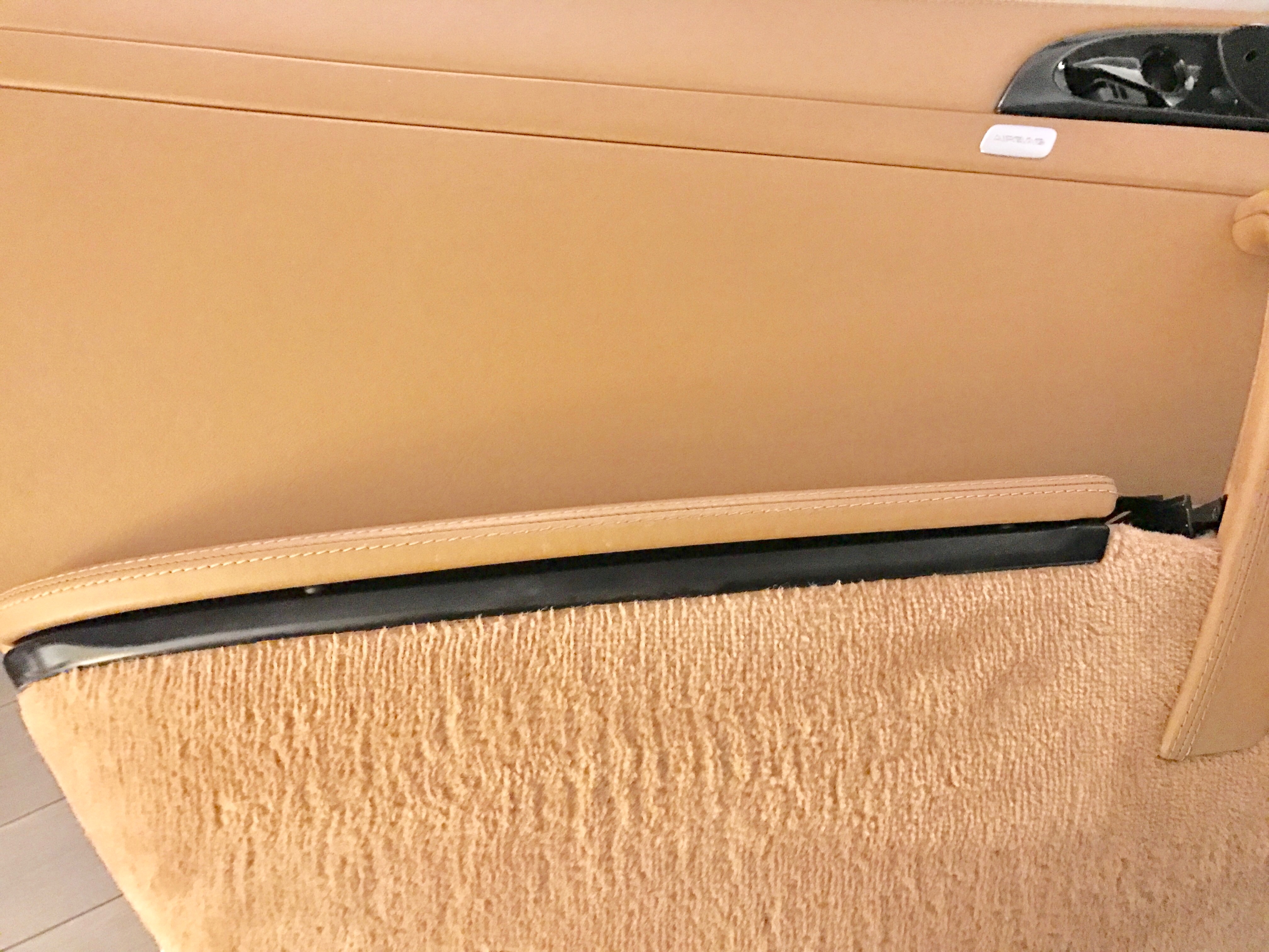

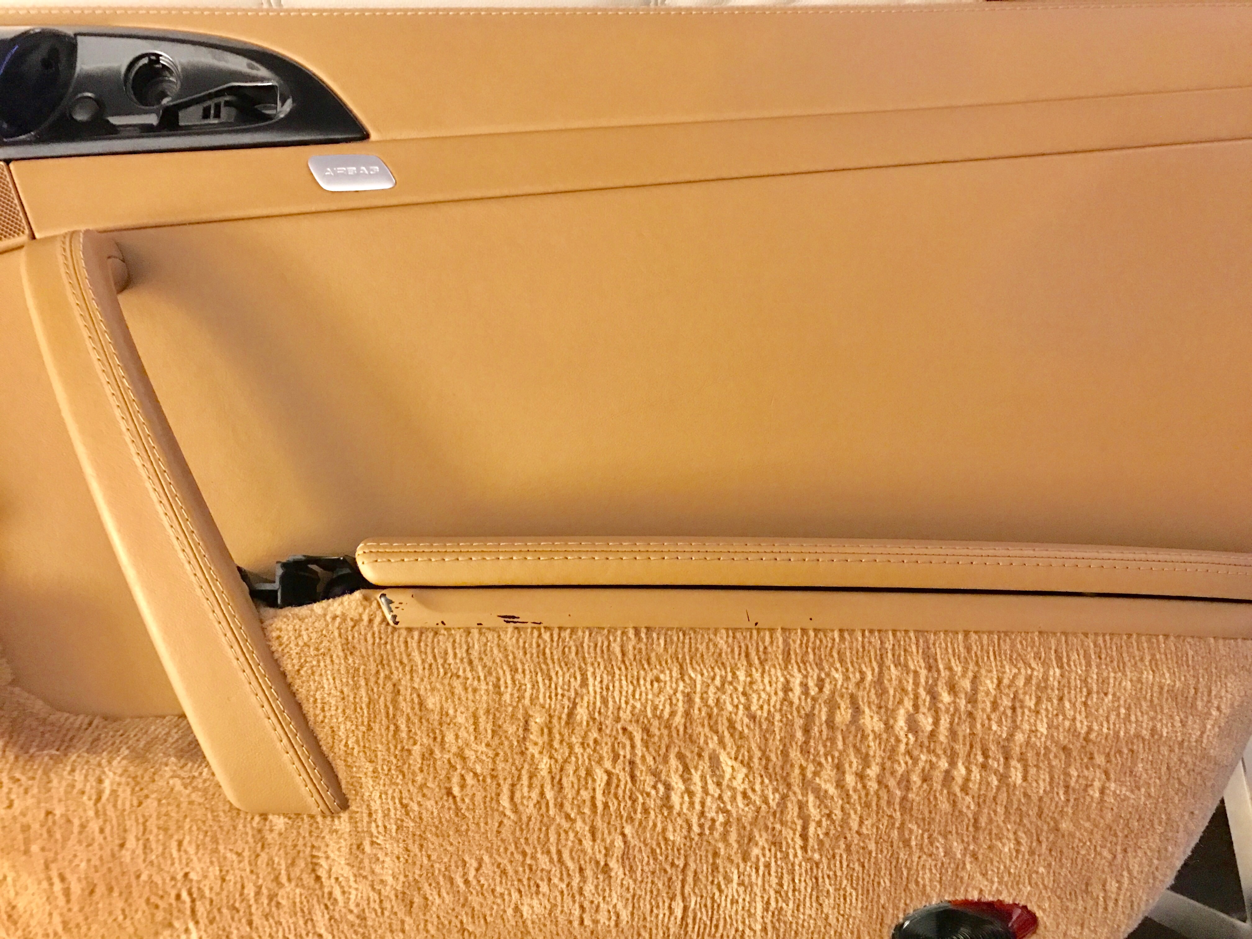

I decided to use some nail polish remover to scrap the soft paint off. It was hard and time consuming. can anyone recommend a better solvent to remove the paint? still have the passenger side to tackle.
